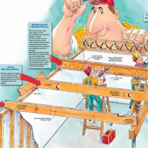

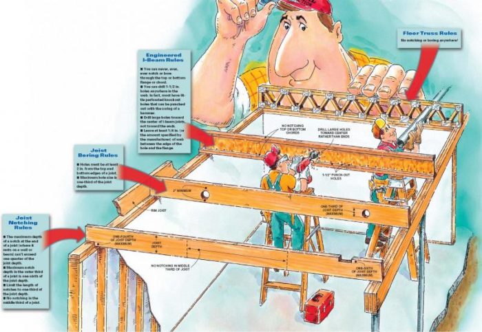

I’m familar with the general rules of thumb for drilling-notching joists scene here in this handy info-graphic.
I want to make sure I’m clear on a couple of things-as I’ve got a ton of holes to drill in my floor joists and I’m pretty darn nervous about swiss-cheesing them.
I’ve got 2by10s that are 22′ long with a bearing support wall in the middle.  Does this mean that the no notching in the middle third of the joist occurs in the middle third of each 11′ span?
I’ve got to drill holes for electrical, gas lines, plumbing lines and pex lines for the radiant heating.  I will follow the size and spacing rules for drilling holes but what about the number of holes?
I’m worried that I’ll seriously comprimise the joists even by following the rules with how many holes I’ve got to run?

    Sorry I guess the infographic isn't so easy to read...its huge actually...still though I would like some feedback...

      The fact that you have continous joists means the bending stresses are spread out a bit in the center, but essentially you should treat them like two 11' spans.  Leave 1 1/2 to two times the diameter of any hole before drilling the next hole.
