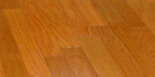

Last one that I did (Kahrs) used 1/4" staples, 1 1/2" long. No pull-through possibilities.View Image
The Bostitch stapler that is designed as a dedicated engineered floor stapler, is the best solution.

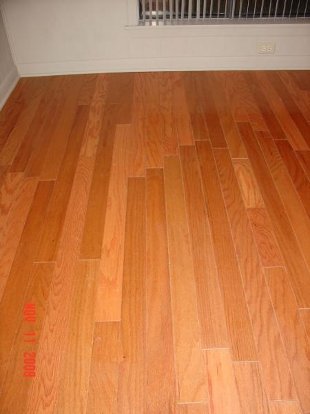

I shake my head when go to a friends' house here in AR where they hired a "handyman" friend of theirs to install engineered HW flooring in their 8x10 dining room. He'd never done glue down of such flooring before but sold them on concept he could "do anything".
They were so pleased with how it looked (please realize the orig flooring was hideous) but when I first saw the completed job I was horrified.
I quickly saw his "DIY-type" mistake number 1 and couldn't hardly get past the impulse to comment on it. Installer failed to READ THE INSTRUCTIONS and clearly had no idea what he was doing to begin with. How was this evident? Simple. He laid the flooring strips side by side in rows that broke to next piece in alignment and had adjoining strips with butt joints within an inch of adjoining strip - repeatedly! - for over 8 strip rows! and of course that horrific pattern just repeated down the strips over an over until one reached terminus of the strip at the wall. I basically "gacked" when I saw it. But swallowed hard and said nothing since the HOs were evidently pleased with the new flooring (and I think: flooring is ok, installation of it is pathetic!).
But again - even a "never done it, know nothing" would benefit from a once thru of READ THE FRIGGIN INSTRUCTIONS - the basis of the acronym: "RTFI" because they provide info on more than just acclimating, but funnily enough, "installation instructions" cover just that! DOH
I now look at that floor anytime I see it and think: what a perfect example of ego over competence...and a WASTE of the cost of the entire job. (BTW - I can get you a picture of this horror if you'd like to see what I mean.)

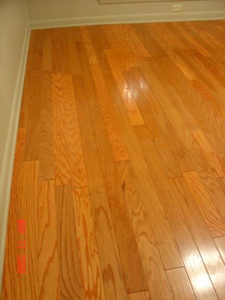

You asked for pictures of a lousy floor job (in MY opinion) and here's photographs showing my candidate for the "Hall of Shame" folder of poorly done work. (what - that folder doesn't exist in the Photo Gallery? hmmm, maybe it should)
Look at the butt joints of the strips. Look at the "clumps" of coloration. And what the photos don't capture is there's also a glue-down failure JUST inside the threshold from kitchen to the dining room floor that this is. Gee, you don't think that'll get noticed much in that location...?

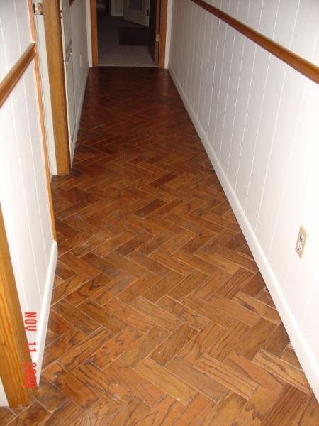

And the other "real shame of it all" is that in the same house, over in original portion with original parquet herringbone flooring, you see original installation - workmanship that's holding up to this day. OK, so maybe this type of flooring is not "in vogue" as much as it once was but my focus is on the workmanship of the installation.
So for comparison -

Yikes! I kept saying owwwwwwwwww-ouch!!! to myself seeing those pics! I was gacking for sure.Shred, are those, what, prefinished 2 1/4" T&G strip flooring?Potential saving grace if it ends up with the furnishings covering most of it.Add:I'm guessing that the install sheet had a word or two about staggering. Ya think?

2 1/2 to 3" prefinished strip flooring - yea I'd say so

The stairstepping doesn't look that bad, maybe because the individual pieces are so short. However, he should haved culled out a lot of the off color pieces and the flat sawn pieces.

I absolutely disagree with you that the stair stepping was ok. But hey, we're all allowed our own opinions!

I said "the stairstepping is not that bad" - that does not mean it is good. I certainly would not do it that way. Attached is a photo of a floor I did in August; this is how it should be done.
