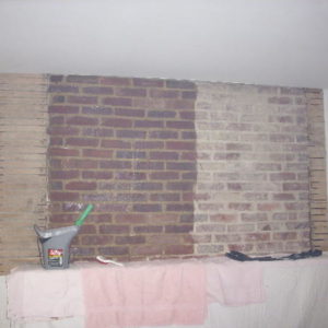

Here’s what I did today:
The left side is already cleaned with with a 50/50 solution of muriatic acid and the right side is what is looked like before.
Here it is all done:
I was pleasantly surprised at how effective a mild solution of hydrochlric acid is.  I rinsed it thouroughly with fresh water, but I didn’t use any soda ash to neutralize it.  Do I need to?  And can I use baking soda or do I really need soda ash?  I don’t even know where to get some.
  1. Henley | Apr 09, 2008 02:34am | #1
    I've never had to.
    just keep washing with water.
    Two or three rinsings seem fine.
    That said I usually use a fairly week
    solution of acid. If yours was strong rinse more.
    Woops just reread your post.50/50 is
    a stiff drink. I think water is still fine,
    but rinse it very well.
    Edited 4/8/2008 7:36 pm ET by Henley
    1. dedubya | Apr 09, 2008 03:28am | #2
      yep fitty/fitty is pretty hot. rinse plus rinse somemore and more..  muratic is a weaker solution of hydroclorlic acid . what were you trying to do etch " exposing new brick face "or just clean them.
      1. DonCanDo | Apr 09, 2008 04:57am | #3
        I wanted to clean them.  They had been plastered over and the plaster was quite stuck to the face of the brick which will now be left exposed.
        I did 50/50 water/muriatic acid mix.  Did I go too hot?  It worked well and I rinsed pretty thoroughly,  but I was a little concerned about leaving acid behind, but I don't know what would happen if I did.
