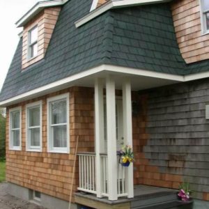

          here's an example on a red cedar sidewall over a steep pitch gambrel...
          black coil stock apron flash
          Edited 7/2/2005 12:57 pm ET by Mike Smith
          1. theslateman | Jul 02, 2005 10:10pm | #13
            I prefer a metal that I can solder the corners on-copper,l.c.copper,freedom gray,etc. In that way you can have perfectly watertight joints where you go from horizontal to a vertical run.
            The actual distance for the reveal is a matter of choice it seems-as long as it's not tight to the roof and the siding is well primed prior to the install.
