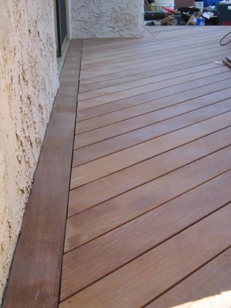

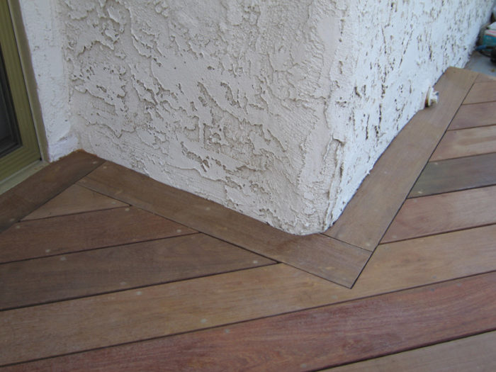

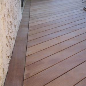

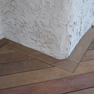

          1. joewood | Apr 26, 2005 02:52am | #10
            Here's how it turned out. The route didn't wander at all, not a gap anywhere.
            We used real tiny screws (plus glue) to hold the inlay down, couldn't countersink them for plugs (inlay's only 5/16" thick) so we filled the tiny holes with sawdust and glue.Used Seasonite to seal this deck. Real pretty ipe, and soon it'll go a beautiful silver.nothing like having the right tool to do a nice job !
