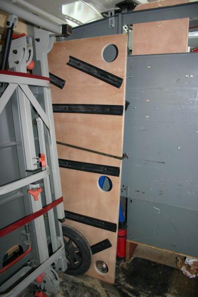

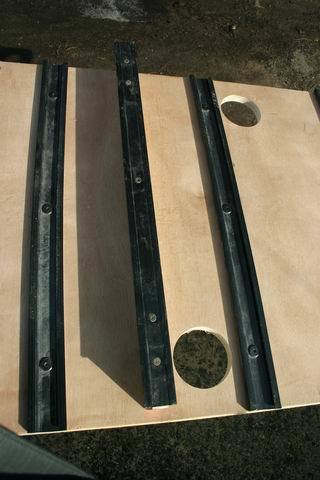

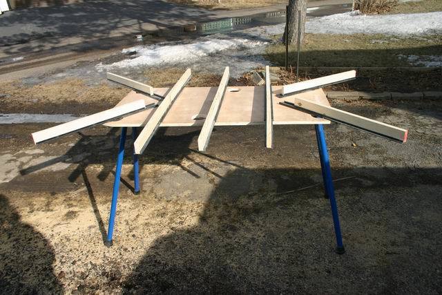

I was using my table today and happened to have the camera with. I am so pleased with the way this thing works I decided to take some pics and post here. All I got from Eurekazone was the plastic rails and guides (and screws that come with) – added my plywood, legs, and some one bys and have a much used piece of equiptment that really doesn’t take up much room in the van.

Nice pictures. Nice legs too. But the legs are too narrow on the top.
You may want to screw some 1x3 all the way around the plywood to keep it straight. If you use folding banquet legs you have wider support in the top and you don't need to "frame" the plywood. If you can get some L shape aluminum instead 1x3s it will look even better.
But 'your" legs look better. Can you give me a hind about the holes?
If you stop over Sat. you can get 3 more bottom tracks and you can use them side by side with the other 3 bottom tracks so you don't have to remove the top 3 top when the table is not in use.And the same time you have 3 more supports when the table is in closed position.

I bought some banquet table legs to make the table but, as Paul mentioned, they didn't fold flat. I had the rugged buddy legs in the garage that I had purchased for something else several months ago, and decided to just use those and return the banquet legs. My plan was to throw together a table to use that day and make my ideal one down the line when I have time.
I thought about putting some one bys on the bottom of the table for support, but as I just mentioned - I plan on making a better table down the line, and the piece of plywood I made this one out of has like 11 plys and stays very straight - good enough for now.
The holes are simply to make the table easier to move around. I had the hole saw chucked up in the drill and walked by the table as I was going back to the van to put it away. Drilled a hole for a handle to carry the table. Got a little carried away myself I guess. Think at the time I had a reason for a couple of the other ones too, but, can't think of it now - guess I just wanted my table to look like the sawhorses Blue posted pics of a while back. Anyway, the holes make for grab points when moving the table in the van or around the site.
