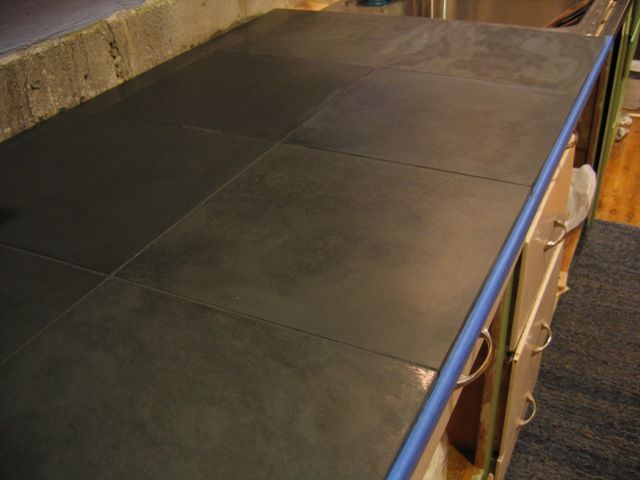

Several people have mentioned honed slate tile.
Here's a picture of a honed slate tile countertop I put in. 1 foot tiles were all that I could find, but it worked out fine. It's brazilian black honed slate, installed over a steel square tube for the edge- not farmhouse style, but you could install it over wood too, leaving a little reveal at the front edge.
1/16" grout lines, with epoxy grout, and it's quite easy to clean up. I sealed it with a tile/stone sealer, and then paste wax, to redo a couple times a year.

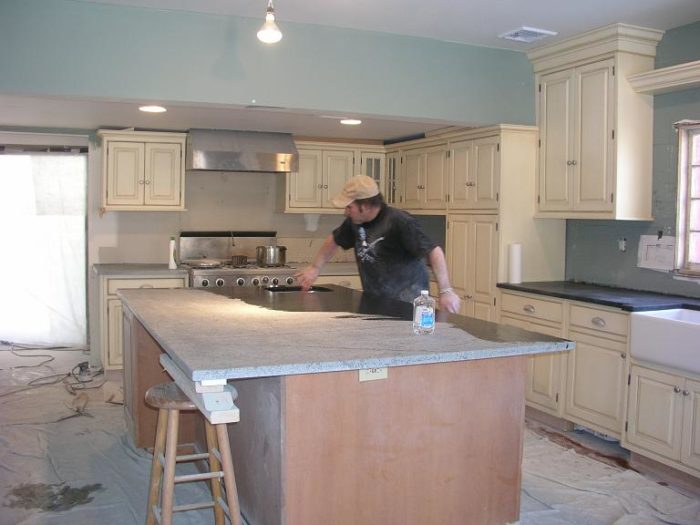

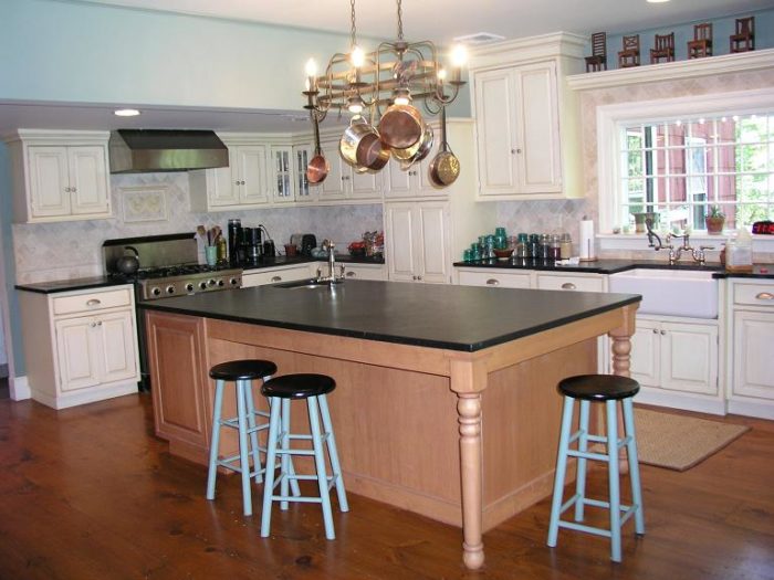

Don't let the shine fool you. I JUST oiled them for that picture that went into my web site.
Soapstone is a really mellow natural stone. To me...it has an incredably organic feel to it. I've had all kinds of counters and I like the soapstone the best...hands down. And the fact that
I was able to fabricate it all myself made it seriously cost effective.
You can see in the picture the farm sink I used as well.
If this wasn't a house I was going to sell in the near future I'd have built/designed it much more rustic....with taste of course.

I also used http://www.soapstones.com. I had a very good experience with them. They fabricated my countertops from templates. I would recommend them. They also have low-talc soapstone, which does not scratch as easily as the normal stuff.
The scratches and dings seem to be really minimal to me and when it does scratch all you need to do is take a piece of sandpaper and sand it out if it bothers you/whoever.
Anyone that uses granite necause they're afraid of scratches better not scratch the granite because thats a REAL pain. And dings? I don't even know what anyone's talking about concerning that. If someone smashes the counters that hard then they better take a chill pill.
And knowing what I know now...how easy it is to fabricate I think next time around I'll go a little crazy adding cutting boards etc etc into it.
The only thing that was an issue to me was all the dust...whewwwwwwwww!!
I'd sand most of it outside next time...thing is though...the island counter took a half a dozen of us to get it just a cpl a dozen feet and even then....whewwwwwwww. You just really have to get serious about sealing up the room and putting fans in the doors and windows.
If I oil it once every three months..thats a lot and that takes all of five minutes to do my whole kitchen.Creation arises, is sustained for awhile, and then things change. That’s the dance.
