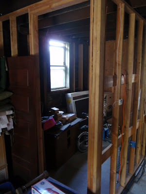

Okay so when last we left off we talked about coming projects on the house. The main project we’d like to focus on is turning this room into a finished fabulous bathroom. I’d like to restate that we already have permits to finish this bathroom.
View ImageCrammed full of crap which is our way…You can see that I’ve done the initial framing for the bath with backers for towel bars- grab bars.
