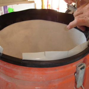

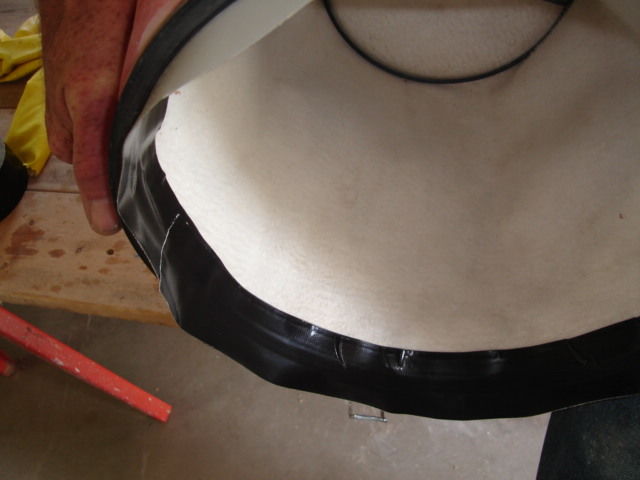

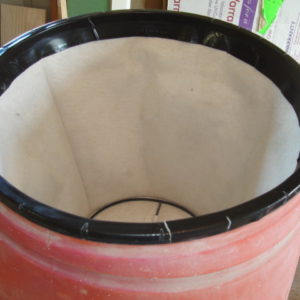

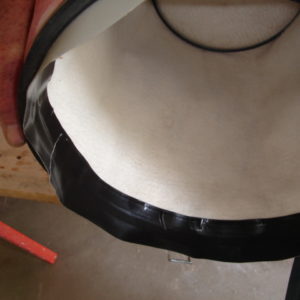

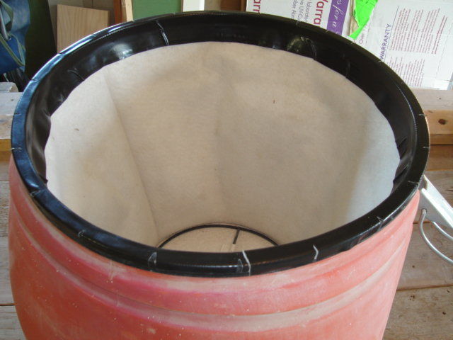

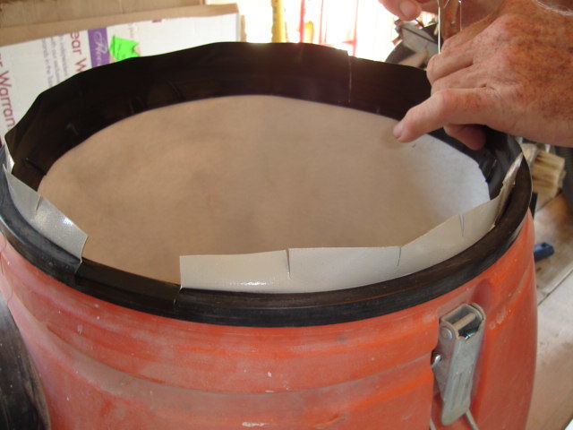

Today for the first time there was dust INSIDE the Fein filter (2 years old). On closer examination there were 2 – 3 splits or developing in the plastic ring at the top that hooks over the container.
Fortunately we noticed because we were ready to vacuum some drywall dust – besides blowing it through the house it would rip the motor.
This is reasonable since the filter probably “waves” constantly in use – plastic fatigue.
Gorilla tape (I’m likin’ this stuff more and more) worked perfect to fix it. One key: put the filter back in the container (insure correct shape). Lining up the tape with the plastic inside, then slitting the tape 1 1/2 in apart ALMOST to the rim.

      Fonzie | May 09, 2007 05:28am | #5
      Hey andybuildz,
      I really like this vacuum.  It is amazing how it just keeps giving a powerful suction with all the stuff you know about on the job and you have to remind yourself to service the filter - I've never had a vacuum like this.  The shop vacs seemed to plug up within about 3 minutes.
      This weak point just showed up.  Last week.  The plastic at the top of the "top hat" or "inverted lampshade" filter hooks over the rim and the vac normally never puts out any dust.  Of course if this had gone unnoticed it would have meant drywall dust in the motor itself - which would have killed it as you mentioned.
      The Gorilla Tape (8.50/roll) seems to have been designed the perfect width for fixing this problem.  I think it's fixed for good.  Fein knows how to charge for their stuff (although I got this vacuum for 230$ on Amazon) -  maybe this flaw will get back to their engineers, who knows.
