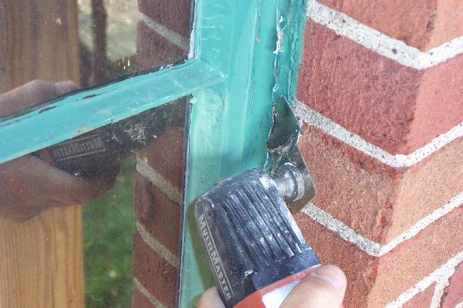

Which blade (part number if you have it) do you use to remove hardened caulking from the exterior of windows?
Is there another tool that will do this more effectively?

    Tom,   what you want is the "scraper".  Should have been in the Kit  I'm sorry I copied more than I wanted to.  The fixed scraper blade is what you want.
    Shaving
    Fixed Scraper Blade
    For removing residual carpet and tile glue, descaling, underfloor protection and damaged coatings, etc.
    Order Reference 6 39 03 178 01 7
    Flexible Scraper Blade
    For removing layers of paint, adhesive remnants, stickers, elastic sealant in the domestic and sanitary sectors, etc., pack of 2.
    Order Reference 6 39 03 165 01 3
    View Image  close window it.

      Thanks calvin. I haven't bought the kit yet which one are you referring to? The basic or the one with variable speed?
      The caulking is really hard I was thinking along the line of a blade with teeth. I'll take a knife and give it a try may be the scraper would work.
      1. calvin | Jul 21, 2005 01:29pm | #3
        The softer caulk cuts easier but I've had luck getting in between the brick and caulk with the scraper blade.  I don't know that the toothed blade wouldn't clog/dull up right away.  If not, then I guess I would try their coarsest blade.  They have a super fine E blade and one that is a bit more aggressive.
        As to the kit, I believe they have a boxed kit for either the variable of fixed speed multimaster.
        I've used the scraper blade on hard window glazing and that worked w/o cutting into the wood sash if you were careful.Remodeling Contractor just outside the Glass City.
