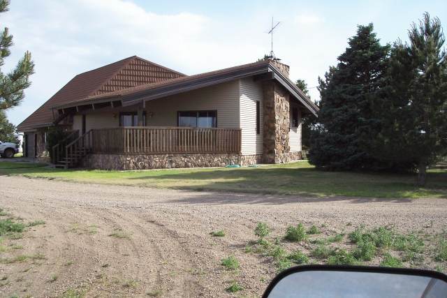

Sometime in the 70's, an existing house had a timberframe gluelam structure built over it and added to the side. Quite a few years back, the ridge started sagging and posts were added to correct it.The job I am doing for them involves taking a sliding door out and replacing it with a window. The door will not open because of weight from above. The pressure is from a rotting exterior gluelam post which was put down off center on a pad without a base. The post holds an exterior beam which is twisting and is toenailed to the post. The post is rotting and has belled out and settled down approx. 3".I need someone to spec out what connectors, post and base I need to use. I need an estimate of weight and a good jacking strategy. The homeowners have noticed some settling;dips in the floor that didn't used to be there etc. Given the history of the house and that it has so many bad construction details, they are spooked and would like to have someone assess the whole structure.I'll try to get some pics posted tonight. We're out in the sticks without any real Code/permit issues, it just has to be done right.

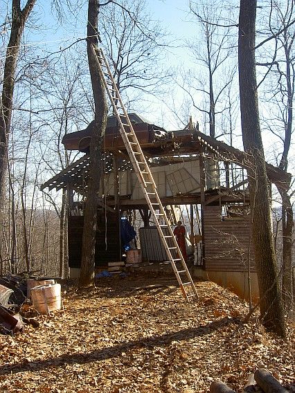

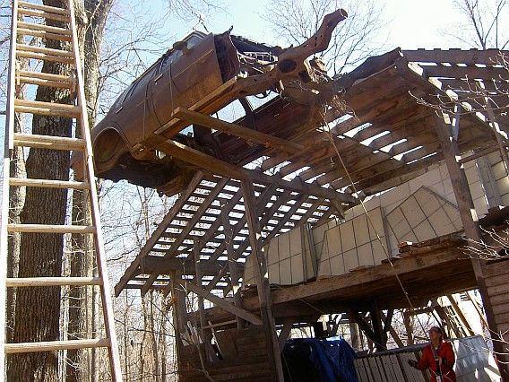

OK, risking further digression, here it is, dangling from a cable. Lacked a few inches of successfully making the ascent. Further tensioning the cable started to deconstruct my rooftop tower. Oak's strong, the Cat was stronger, cable did fine.
Caution is good. Those who don't have any idea of what they don't know are dangerous. You've got movement, something caused it. Unlikely it was the gluelam experiencing mc movement. <G> You need to follow the load path.
Woodturner, maybe you shouldn't look. LOL It was a day my 2 buddies and I treasure. But the remainder of the old boat was heavier than I'd thought.

Would've been grand. Everybody meets guests at the door. Not many honk, roll down the window and wave.
LOL... wrong tense.
Will be, not "would've". It'll happen. Just need a shorter building. That one has 4 floors. No idea what I was thinking... But originally planned for another half floor on top. I really don't have a land shortage.
Was gonna cut off the whole back end but then I remembered a MadMax movie scene (Thunderdome). Access through a car trunk. I removed the pan there too, gonna be a roof hatch.
Caution: cutting a floor pan off a car is an incredibly nasty fire-prone job. I set up fans, wore a serious respirator, and liberally used a fire extinguisher (cut 4", extinguish, cut 4", ...).
No chance, after all that, I won't use it.PAHS works. Bury it.
Sawzall goes through cars like butter.

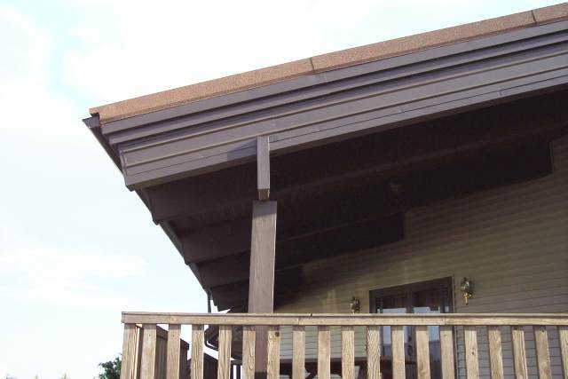

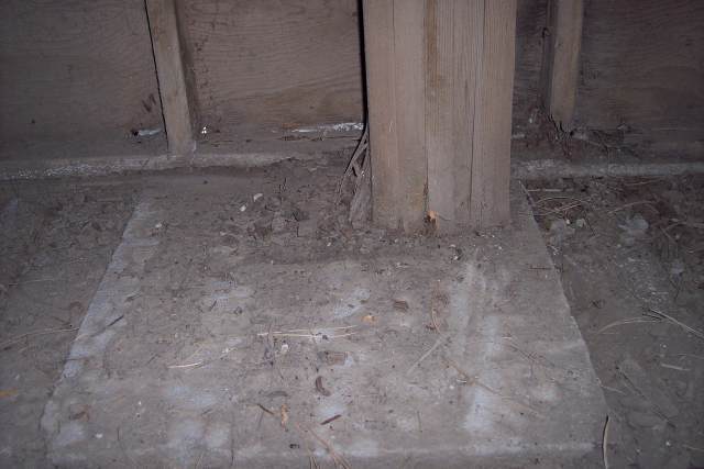

Is that the post in the picture? I can't see any 3" movement, where is it?
Is that beam that is twisting a solid timber that has taken a twist? Or is it tipping because the post is leaning ? Looks like it droops along the eve, are the last 3 beams all low, or is it just the pic?
What is supporting the ridge? That beam next to the chimmney the ridge? Is there any movement there? The siding looks ok as far as I can tell in the little picture.
Which slider is binding, looks like there are 2? Is the far post done any differently? Are the posts both plumb, or is the closest leaning toward the ridge?
Joe H
The post is the closest one. There are blocks which once supported the decking nailed to it and are now about 3" below it. When checked with a laser, that's about the same difference between the post heights. The post is about 1 1/4" out of plumb (tipped toward the ridge). The beam is rotated away from the ridge. The rafters are notched--not birds mouths, but notched around the beam.The other post is plumb and has no rot at the bottom. Same details, but in protected drier spot. The beam there is tipped outwards, but not as bad. I can't see any signs of movement there.The beam under the ridge puzzles me. I think it might have been added when additional posts were put under the ridge after it started sagging.The sliding door with the problem is the closet to the post with the sagging rafters over it. The beam is a glue lam. I'm thinking it was never really plumb. I think you're right, the post tipping toward the ridge is making it worse.
The pic labeled rot is puzzling. The post looks mostly intact, I don't see 3" of rotted material that would account for the appearance of the eve.
Has that concrete sunk that much? Seems it would sink in the corner due to the way it's loaded, but it looks to be level.
It's a mystery, but if it was mine I'd be replacing the post, maybe get it up off the ground a bit so it's not getting wet. Looks like some staining in the background, although nothing extreme.
Looks like a sidewalk along the bottom of the porch, is it funneling water under the porch?
Joe H
I'm puzzled by it too. The stud wall behind the post is setting on a stem wall. The concrete the post is setting on appears to have been placed at the same time and there is no difference in height between them.I brushed away a lot of powdery,punky wood to look at the concrete. I'm guessing that as the post rots, the weight mushrooms the rot out.The deck joists are supported by an untreated stud wall with plywood and synthetic stone over it. In some places, either the sidewalk funneled the water under or there is a leak in the stone which the mortar is falling out of. Some places the stud wall is good, some bad. Another problem which needs to be addressed.The porch deck is 2x6 with spaces between. With a little wind, rain or snow can get directly to the post. The post is on the N. side of the house and likely has drifts against the wall and piled on the deck.Good questions. It's making me think things through.
