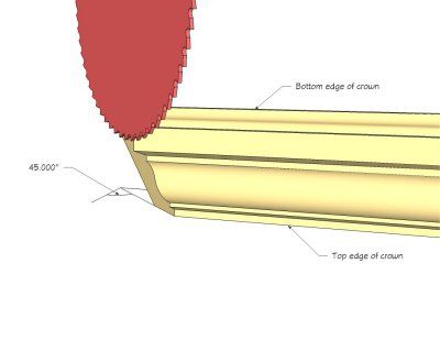

Here's some pics of a model i made a while ago. May help you understand the crown coping cuts.
Cut the crown updise down and backwards.

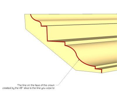

Your cope line will be the edge along the surface of teh moulding
do what ever it takes (cope, grind, sand, carve, blast, etc...) to remove the material beyond the cope line. When you cut, angle the cut to remove more material behind the cope line so minor irregularities don't affect the seating of the cope to the mating piece of moulding.

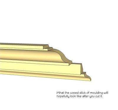

It ought ot look something like this when you're done
Next step is to be sure the shoot the trim up at close to the correct spring angle (as long as you had the trim in the miter saw close to the right spring angle). I generally don't shoot too close to the end of the first piece (the butt cut) so I can still work/adjust/twist it to fit the coped piece.
