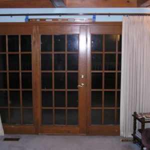

Hi all… Homeowner looking for advice.

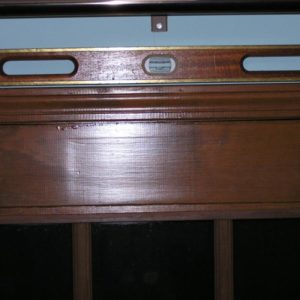

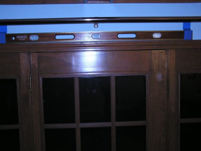

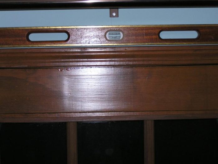

I have a 3-panel french style patio door where the header appears to be sagging in the middle. I say “appears” because I can’t think of any other reason why the top of the door would be rubbing against the door frame. The top door frame is about 1/8″ to 3/16″ lower than the sides at the center of the door, plus there is a vertical crack in the drywall right above the center of the door (at the “low” point).
I have not pulled down the drywall yet to see what might be the problem, I wanted to get advice from you experts first.. When we had the house built 18 years ago I thought the header beams installed were 2X12’s or 2×10’s, but until I open up the wall I can’t say for sure. Now that I think about it, about 10 years ago I trimmed 1/4″ off the top on the patio door bescaue it was rubbing back then – so the header beam must have sagged about 1/2″ over the 18 years.. 10 years ago I never thought to consider a sagging header…
Below the door is a basement and above is a bedroom (two story house). Is this something that I can attempt to fix by replacing the old header with the new enginered wood beams?? I assume I would likely have to put jacking post(s) in the basement to support the first floor and jacking post(s) on the first floor to support the second story (all near the patio door area) while the header is being replaced. And I would completly remove the door unit.

    edited to ask what is on the exterior of the building..siding, brick?
    Are those false beams in the pict. over the door

    1. mark14 | Jun 18, 2006 07:35pm | #3
      The exterior of the house is cedar siding and the beams in other the picture are just decorative. You gave a good idea if using a single door with sidelights, but my wife & I want to replace the french door with a 3-panel sliding door (where the center door slides). So if the header is sagging, it will need to be fixed...

    1. mark14 | Jun 18, 2006 09:27pm | #4

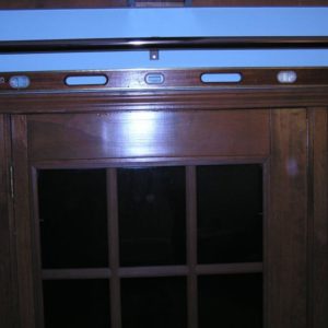

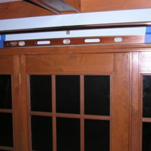

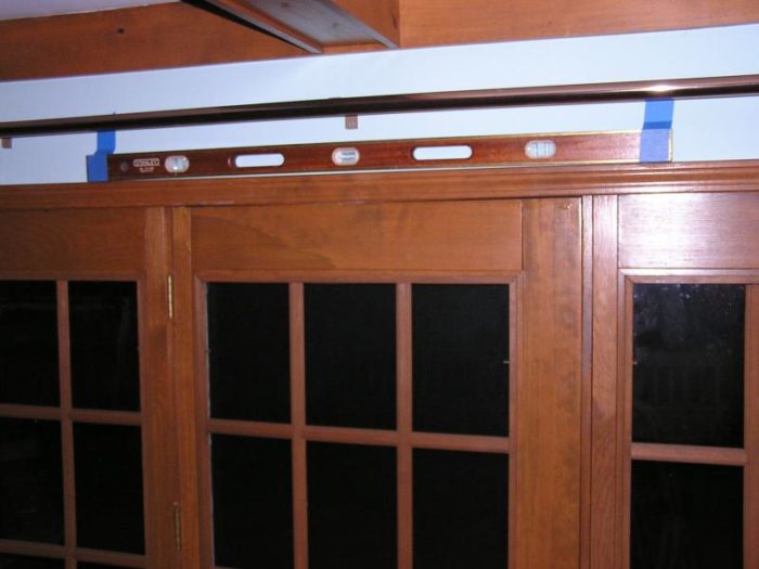

      Mr. Sledgehammer,Looks like you were exactly right!! The sheet rock was tight to the door jamb frame all the way across the top (see pics). When I cut out the sheet rock back up to the header height as you said, immediately a gap between the door and jamb frame of about 3/32" opened up. The jamb frame over the door area is pretty deformed now, about 5/16" bend - can I put a screw in the center of the jamb frame and into the header to try an straighten it out??thank you for your comment!! I was worried that it was a sagging header that would be a major (and expensive) repair...cheers! mark
      1. mark14 | Jun 19, 2006 12:15am | #5
        Well, I cut the drywall all the way across the top to be even with the header.. lo an behold - the door is no longer rubbing against the top of the jamb. the top door jamb is actually a little straighter now, not by much, but it has eased. There is still a noticeable downward bow, but it's a little less. The sheet rock on the left and right sides of the door, was actually bowed out from being stopped by the fixed window units. it was forcing the trim molding out. Plus, the top jamb frame was actually compressed about 1/16" over the vertical supports between the door and side window units.the gap at the top of door went from 0" to about 1/8" clearance after about 2 hours from cutting back the sheet rock. The header looks perfectly straight all the way across the door unit...Looks like it was just poor "sheet rocking" work..Sledgehammer, thanks!Edited 6/18/2006 5:49 pm by mark14
