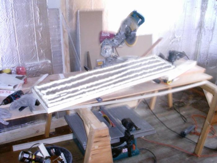

I'm trying to get a picture of the back of the foam, and I see that 2 of the files of the picture are actually video. So let's see if the 3rd is a charm.
Clay
Ok Last one I promise, I need to figure out how to keep the picture to a small amount of pdf bits.
This one shows a full panel with some sticks to keep pressure on it while it cures. This is the same thing that is going to hold the sheet rock on.
Clay

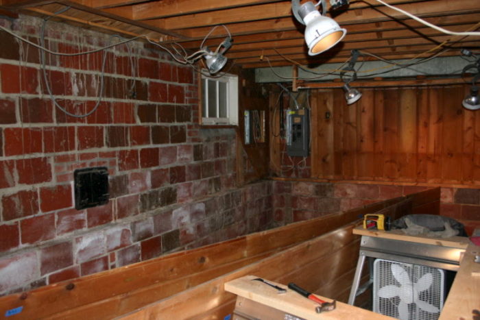

On the walls, did you use any clamps or screws to hold the foamboard in place until the foam dried? Did the foamboard stay flat after you pressed it down?
Attached is a photo of my walls -- the lower wall is wider than the upper wall, so it makes it easy to use thicker foam above and thinner foam at the bottom which is well below grade.
Billy

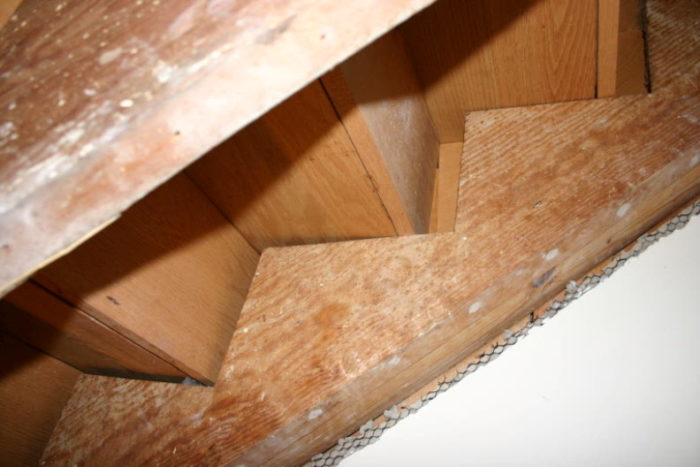

Off topic -- the house is generally very well built -- 3 inch wide joists, etc., but it has always bothered me that the stairs creaked badly. When it came time to do the basement one of the first things I did was to knock out the plaster and wire mesh ceiling in the stairwell to the basement so I could get access underneath the stairs above.
Check out the gaps between the stringer cuts and the stair treads and risers. The damn stairs were floating in air! Apparently they let jacklegs on construction jobs even back in 1938. I glued and screwed blocks in place and the steps are rock solid now.
Billy
If you look at the last picture the 2xs are wedged to hold it flat while it cures. I used both minimal and 3x expanding only cause I ran out, so far from what I can tell it's all working good. If you do a test piece of flat anything,piece of sheet rock or foam or plywood and run a bead of foam, and press it then pull it apart after a little while it kind of collapses most of the expansion.
Plus the deal with what I'm working with is behind the plaster is adobe liner brick which is useless for any holding power. Once its cured it is exactly where you hold it to with the jacks it doesn't move and it's feels better then you would have thought.

The stair pictures look like the carpenter cut the stringers but left the job and let the handicapped helper finish them off. plus in those days they didn't have construction adhesive.

The first time I quickly looked at the photo and I thought it was the ceiling -- I see your clamping method now.
It seems that spraying the foam on the panels will go a heck of a lot faster than using a manual caulk gun to apply construction adhesive. And since it covers more surface area on the foamboard, it may have better overall holding power. With a bead of construction adhesive, it is a real mismatch to have hundreds of pounds of holding power on a 1/4 inch wide strip of flimsy foamboard.
