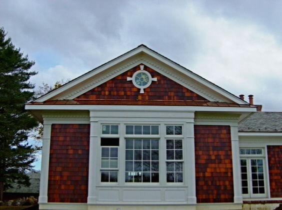

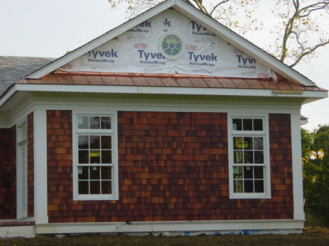

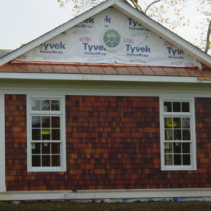

        Here's a couple pics of 4' hip returns with copper roofs I framed.Joe Carola

          Wow! Keen work Joe. I just got done going through the posts about framing a hip over an angle bay.
          In this pic, I would like to see the returns 'joined' so to speak so that they run all the way across the gable thus providing some protection to the windows and doors.
          If that were the case, is there a name for that element?

          2. Framer | Nov 04, 2006 03:13pm | #9

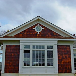

            Thanks Eric. I just call them full returns.Here's a couple pics of a house I did I framed,sided and trimmed with full returns.Joe Carola

            RRooster | Nov 05, 2006 08:36pm | #11
            DAMN you do nice work!!!!!!!!!!!!!!!!!!  Capital NICE.

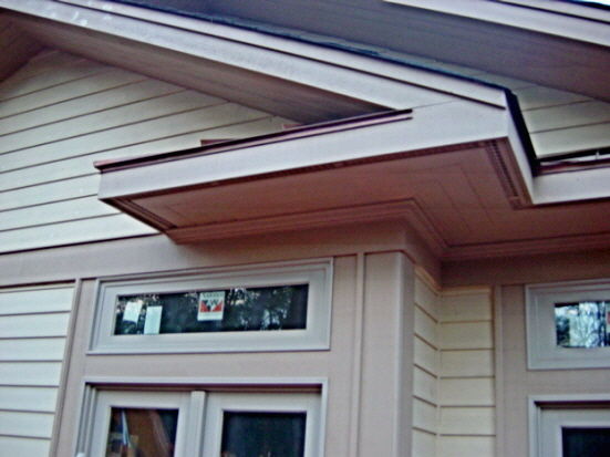

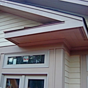

            Thank You.Some jobs I do just the framing and some jobs I'll do the framing and exterior trim and some I'll also do the trim and siding. That job I did everything.That job there the Homeowner didn't want any trim under the gable overhangs, so every piece of siding was cut perfect to fit and butt up against the soffit.Also the trim around the windows I made my own back band out of 2x cedar.Here's a shot of one side.Joe Carola

            also...how did you mate the rake fascia to the horizontal fascia. or does it simply rest on it where they meet.
