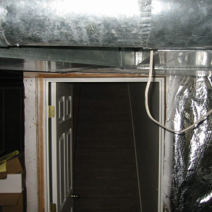

I am finishing a basement and the trunk of the heating system goes right in front of the doorway to enter the basement.  I was able to raise it 1″ to about 1/2″ above the door.  I need suggestions on how to frame around it.

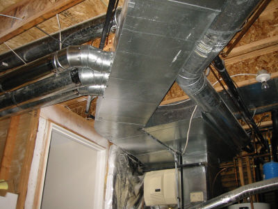

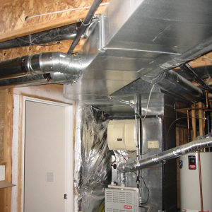

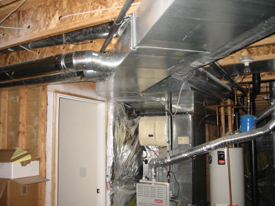

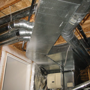

      This is great!!!  I thought I would post this & probably wouldn't hear anything for days or longer.  I am hoping to avoid metal studs.  I have taken a couple pictures I have tried to attach to this reply.  Hope it works just to give an idea of how little framing room I have to work with.  The duct work goes out about 6' from the door to where I can nail some framing to the joist by about 4' wide.  I am figuring on a double sliding door in front of the furnace & water heater.  I need HELP!!!

        That's a bad situation. I'm sure moving the ducts are out of the question, but that would be a good way to start.Otherwise, you are fighting for every 1/8" of an inch. See if you can get a 2X on the flat above the head of the door. Attach 3/8" rock to the bottom of the cleat (parallel to floor) and build the front of the soffit to return to it at 90 deg. Forget casing at the top. Just go with legs OR you might forgo casing entirely and use drywall wraps to the jambs.Good luck....
      2. calvin | Aug 19, 2005 04:38am | #7
        Resize those pics for us antiques on dialup.  640x480 or so.  150kb's max.
        What's the height to the top of that door jamb?  You cant hang board that big w/o fastening in there to framing or it will sag.  If you sheet it w/1/2" ply first and go over with 3/8's board, you might make it.
        You should have a bit of air between that duct and any cover.  Tight fit will pop when you turn on the heat/cool.  You wouldn't like that.Remodeling Contractor just outside the Glass City.

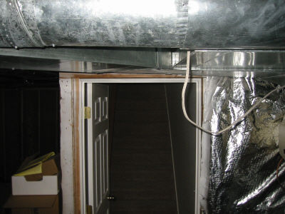

          Sorry about that.  It took me a while to figure out how to resize those, but I did it.  Here ya go.

            What's your plans for the furnace and is this the finished side of the basement that you are cherrying out?
            A ledger above the door and a drop between the trunk and round duct should take care of the area out in front of the door.  A drop ladder or however you do it, in a configuration to surround the sides of that which you wish to cover with a soffit will take care of the perimeter.  If any of the free span is more than 24", sheet the area with plywood, then cover with sheetrock.
            If the door is full size at 6'8'', I'd give consideration to taking a couple inches off and resetting it.  Your choice if you want the knob 2" lower or take an inch off the top and bottom, reworking the side jambs to match up the hinge mortises.
            Never pack the soffit tight to the duct, nor screw anything to the duct.
            Are there any flow adjustments in that area ?  Move those so you can regulate the flow through the ducts.

            I am going to put sliding or double doors in front of the furnace & the water heater.  No other choice really.  From all the input, it seems that the best option is plywood, then drywall.  I think I will try drywalling around the door opening and not use any molding around the door.
            The main part of the basement which is adjacent to the door in the picture will all be one room.  I will have to frame a soffit all the way around the room which will be about 24" wide and 8-1/2" high.  I want the drop ceiling in front of the door & the soffits to be the same elevation so I am doing the hardest part 1st.
            I have no idea what you mean by the flow control for the air.  Are you talking about dampers inside the heating vents?  If so, there are none.
