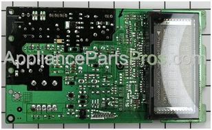

I have attached a couple of photos of the smart board that is for this microwave.

People used to drop broken microwaves off at our (computer) shop all the time for a look. Every one we looked at had a bad clock/control card.
The card was always $100 or so in those days and few people actually wanted to spend the money. You can look around on the net to see if you can find one cheaper.
The one we actually fixed without buying the clock card (it was still the bad part) was fixed with a spring wound timer. We just drilled a hole through the face of the control panel and installed the timer wired directly through the interlocks to the magnetron control card. That was our shop oven for many years.
