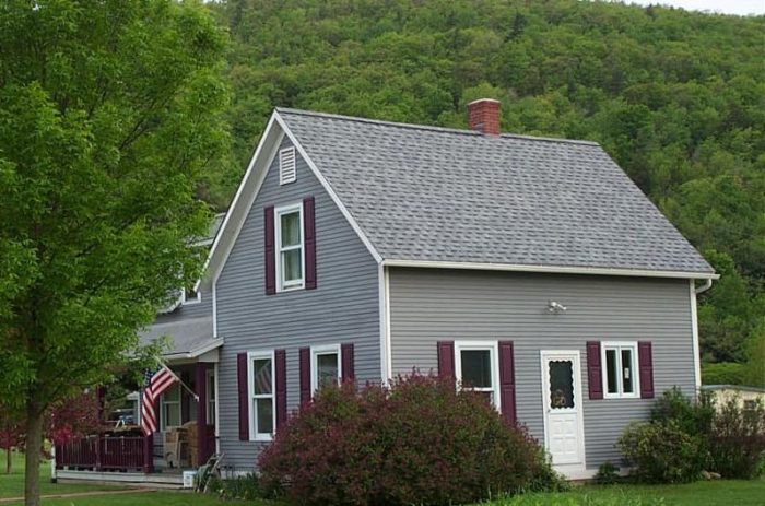

We have gable vents that face the prevailing winds on our ballooon constructed expanded cape. We have installed fire stops everywhere. We just had a new roof put on and installed ridge vents on boths roofs to make it look equal (one needed it).
The problem is: When we have a strong storm, water will come down through the 2nd floor windows just below the vents. I suspect it’s blowing in through the vent and finding it’s way down.
Question’s are: 1) Is it normal for this to happen sometimes and can it cause damage? 2) Should we have both types of vents on the same part? 3) If we can (I like the added ventilation) is there anything we can do to help stop the water? 4) should I just go up there and tack a piece of sheet metal over the vent from the inside and let the ridge vent do it all?

    Maybe this will help. I'll try to post a picture.

      From the sunlight on the house in your picture, the gable wall that shows is either facing west or north (unless you took the pic first thing in the morning, which it doesn't look like). And you're in Vermont. This means that gable vent is facing pretty much into the prevailing northwesterlies. Question: do you get water in through the opposing gable vent (the one on the other side of the house) as well? Second question: during what type of storm does this usually occur? Large, relatively stable lows that move in from the NW with winds that neither veer nor back; or short, violent line squalls (summer thunderstorms, but nasty ones) that come in from all different directions with winds that shift quickly as the storm blasts past your location?
      Another question: You say the water 'comes in through the 2nd storey windows'. Do you mean it drips down over the sill, or weeps down the case from above?
      Finding the appropriate solution to your problem depends a lot on the answers to these questions.
      In general, I don't approve of ridge vents in high snow regions, and Vermont can pretty much consider itself such a zone. What happens to a ridge-vented system when there's three to six feet of snow pack on top of the roof is that any warm air leaving the ridge vent at first melts a channel into the snow pack from underneath, and then, as the channel gets big enough, the surface of it ices over, so you've got a sort of ice tunnel there surrounding your ridge vent. Now the air trying to permeate the snow pack can't do so, because it's hitting a wall of ice, so it just curls around inside what is essentially a sealed pocket. The air entering at the soffits has no exit, so active ventilation stops.
      I'd suggest as a test measure stapling a polyethylene 'bib' to the framing under the vent, and leading it into a large drip pan on the floor of the attic. If your problem goes away, this will tell you that the water is coming in there. You can then decide if you want to (a) close off that vent; (b) install some sort of permanent water catchment and evacuation system; or (c) try to reduce the vent's vulnerability to high wind.
      If the problem persists, then you'll have to look elsewhere for the culprit.

        Thanks for the reply. I forgot that we don't have soffit vents yet. The water comes down through the top of the window casing only on really violent storms. The gable vents face north and south. Picture was taken from the southeast. Thanks to Global Warming (although I didn't hear it mentioned much last winter) we don't get much snow here anymore. Please read my reply to Mike Gabriel below.

          Check the head flashing on the window. The vent might not be the culprit at all.

            Just so happens the wife had me washing the outside of windows today. So, while I have the ladder up there I checked. Flashing looks good.
