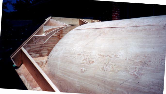

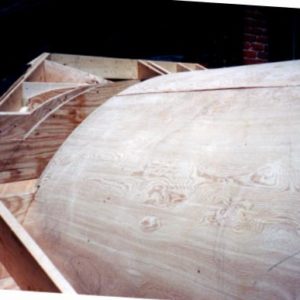

    OK ... email him this pic ...
    and tell him I can be flown in at moments notice ...
    I can get the rest of the building crew also ...
    for a price!
         Artistry in Carpentry
      BossHog | Feb 14, 2004 01:23am | #3
      That looks kinda like what they need to do.
      The roof they need to frame is round too, but dies back into a valley pretty quickly. Is that what the one in those pictures does?Where are we going, and what am I doing in this handbasket?

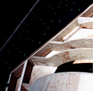

        JeffBuck | Feb 14, 2004 01:34am | #4
        maybe the inside finished pic will help ...
        Remember .. airfare ain;t gonna be cheap ....
        but we'll just need a dirty little hotel room close to a strip bar ....
        Ah ... it's close enough we could drive!
          BossHog | Feb 14, 2004 02:44am | #10
          Looks like that's pretty much what the guy needs to get built.

        JeffBuck | Feb 15, 2004 06:29am | #14
        and Tim ...
        I just helped build that curve ....
        followed behind my buddy Joe saying encouraging things like ...
        "that ain't gonna work ....."
        On the inside curves of the laminated ply ribs ... we learned just how tight a circle you can cut with the circular saw. Made the template with the router and trammel ... but that was taking way too long ... was wanted to make then all ...
        as we were both real curious to if we were anywhere near the right train of thought.
        lotsa flying by the seat of the pants on that one ...
        I started to try and use some formulas .. but Joe thru m calculator off the roof before I could get anything on paper ..... though... I will say ... as a good friend .. he wasn't too proud to try and burn up my saw instead of his cutting all those ribs out.
        It's good to have friends .....

            JeffBuck | Feb 17, 2004 03:45am | #27
            That was the first guess at how we were gonn attack it ...
            then we realised the vaulted interior would be easier ... and follow the same profile ... if we went full depth and ran the ribs "across" ....
            structurally .. either woulda worked ... as the designer wasn't exactly sure how to build it ... so he glum-lam'd the sh!t outta the structure ...
            everything you that little roof section was suported by oversized beams ...
            All that curved roof had to do was hold itself up ...
