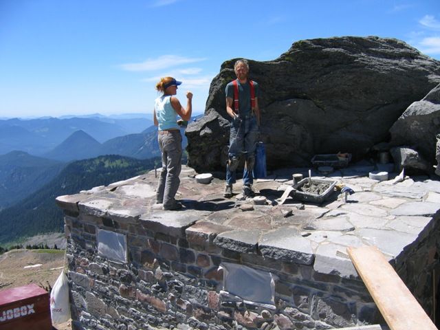

    Do you have a cake decorator/grout bag to put that in with?  You'll want one.  on rock, I use the same mortar that I'm setting with, because usually the mortar/grout are continuous.  So I'll take that mortar, add a little portland cement to make it smoother, and get it to a consistency that I can bag it.
    Here's a picture of some friends working on a roof that we set last summer.
    zak

      McDesign | May 09, 2006 05:10am | #4
      Wait - that's a roof?  For what - a hobbit?
      Gorgeous work, gorgeous setting - what's the story?

      1. donpapenburg | May 09, 2006 05:55am | #5
        If I remember right  those are buildings in a state park . He has a little picture story in the forum some place . It was about a year ago.

        That building in my picture is the panorama point comfort station, at 7500 ft elevation on the SE side of Mt. Rainier.  About 2 miles hike from "Paradise".
        The original roof was flagstones laid on log purlins.  It didn't last so long, as you might expect.  This one has a poured concrete roof (xypex in it for waterproofness) over galvanized planks.  Then we put flagstones (well, up to 5" thick) over that, to recreate the original look.
        Building was built by the CCC in the 1920s.
