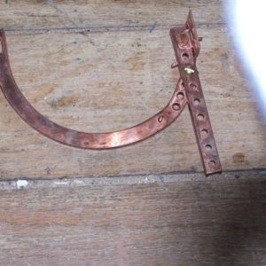

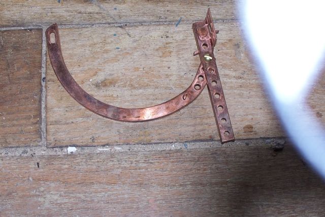

Hey woody, here is the circle hanger
The tab is for holding it while the 4 screws are driven, the line holes are for 1/8th per foot of slope...the little brass screws are for dropping when you are up 30 or 40' an yer hands are numb and cold simultaneously and you can't wear gloves.

I'd GLADLY show you a picture of a half round hanger shank and circle with the adjustable holes and 10/32 nuts and bolts (brass) and the attendant clips that must be cinched w/ channel locks.
