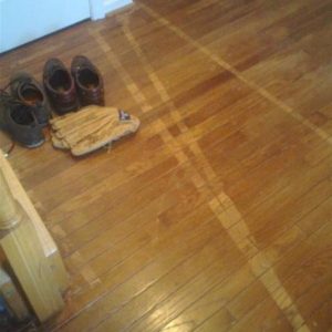

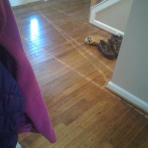

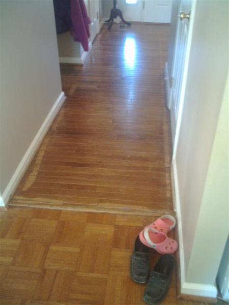

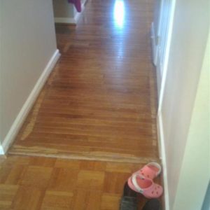

What do you use to protect hardwood flooring during a remodel?
We typically use blue tape and rosin paper, and have never had a problem with it except for the rosin paper falling apart.These pics are from a basement job that we are just finishing. The existing prefinished hardwood is ~15 years old and not in the best shape. When our helper pulled the rosin paper and tape off, he found the zebra… We really don’t need a heavy amount of protection. No work is done on the paper, just foot traffic that we want to keep tidy.What would you use in this situation?

      Holy smokes, Phillip Morris!I would expect something like that on a newly finished floor less than 30days but a 15YO prefiniished - yikes!Did it really take the finish up or did it grab fifteen years worth of ground in dirt and wax? Try a gentle rub across the stripe with Murphy's oil soap and see what happens.We like to use drop clothes from http://www.dropcloth.com

    It seems to have left pretty clean lines.  Did the tape pull up the finish or react with the finish on the floor?
      jonblakemore | Mar 05, 2007 08:22pm | #15
      An update on something recently discovered.We demoed the floor this morning to replace it with a new prefinished floor. When the flooring was removed, it came to light that the finish we pulled off was not the original, someone had applied stain and polyurethane directly over the original factory finish.No wonder the tape pulled it off.We have no idea whether the client was the one who did that, or even knew about it, so it's still a moot point as to if they are charged for the work or not. Either way, I still don't think it would matter. Once we touch it, we own it...
