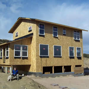

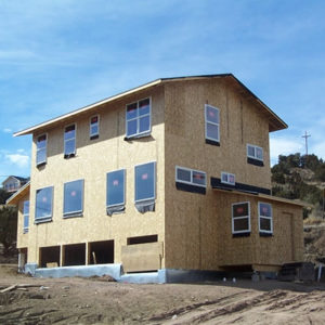

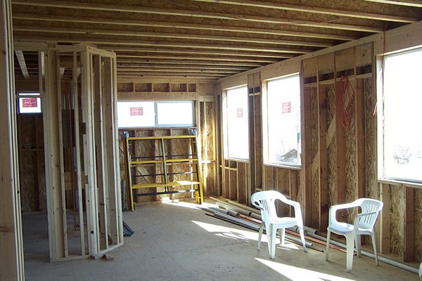

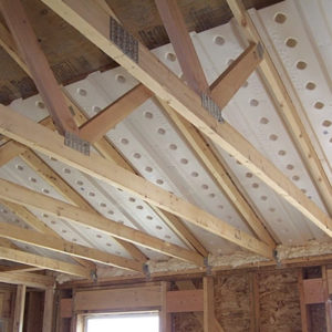

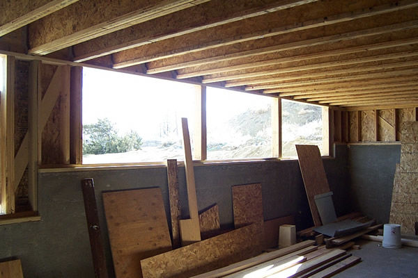

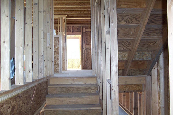

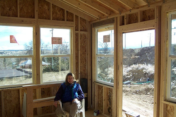

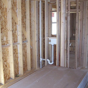

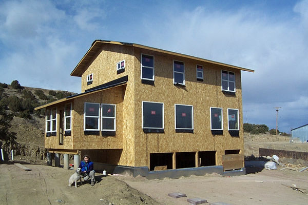

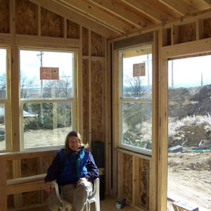

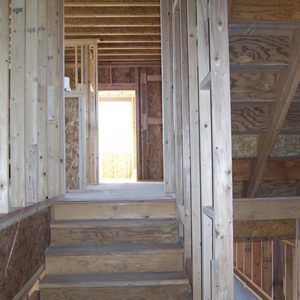

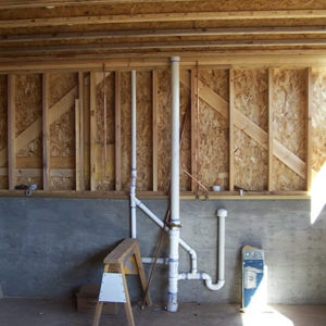

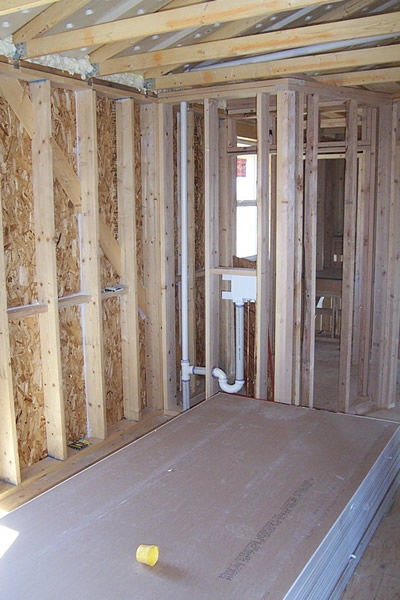

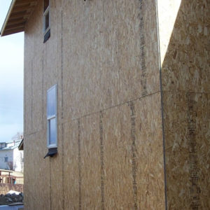

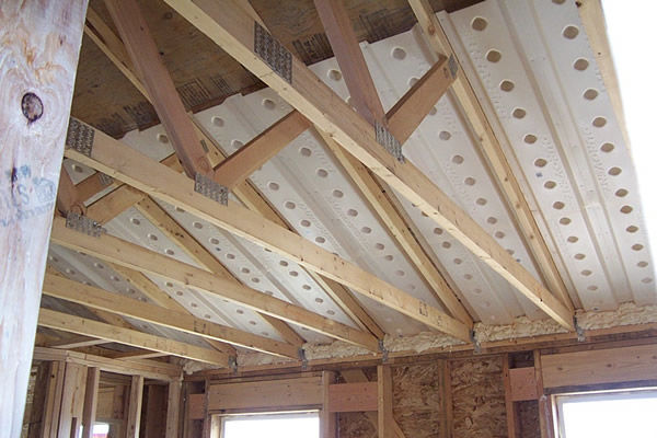

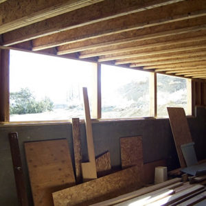

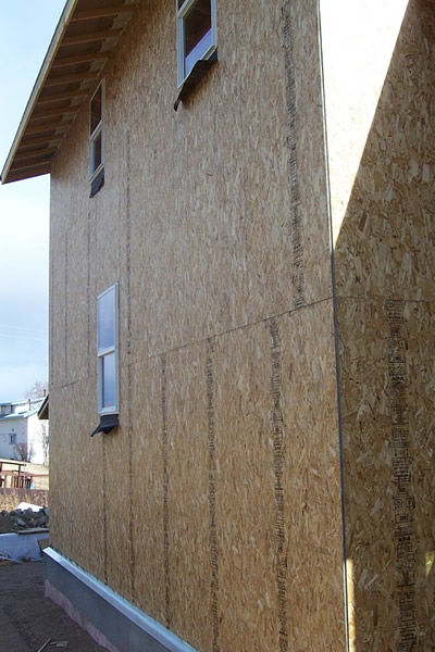

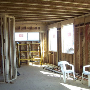

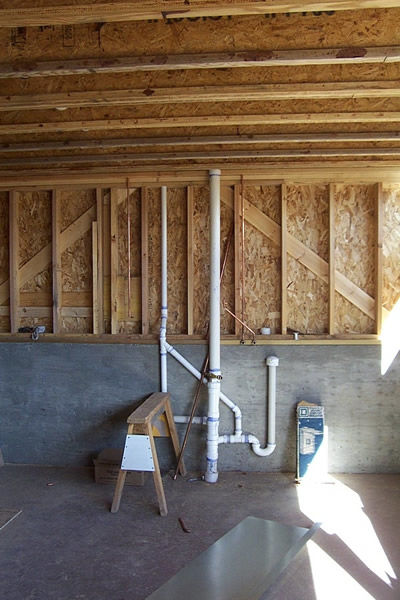

Current progress on our new place:

    JDRHI | Mar 01, 2004 07:28am | #3
    Lookin` good brotha! You doing it all by yer lonesome?
    20 yrs. in the biz and I`ve still yet to work with trusses....your choice or the archy spec em?

  4. xMikeSmith | Mar 01, 2004 07:37am | #4
    big, huh ?..... what are the square openings on the lower level ?
    i like your attention to detail... very neat..
     and what is the siding going to be ?
    1. hasbeen | Mar 01, 2004 08:57am | #5
      Thanks for the positive feedback!  For me it's easy enough to make the framing look pretty good - that's what I have the most experience at.
      24 x 32 on each level / two stories over a basement.  Enclosed and finished, but not heated porches on east and west.
      Dark brown dyed concrete floor in the basement with four large windows facing south.
      Siding will be Hardi Cedarmill 6 1/4".
      Roof will be Metal Sales "Pro Panel II" in patina green.
      Sheetrock in few weeks - good thing I have two strong sons or I'd be hurtin for certain.Something is what it does.

    "It's us simple and lazy types that just buy trusses."
    Hey now - Them's fightin' words......

    Man, I LOVE seeing NEW work...so clean and nice. I wanna come help ya just to get away from 150 yrs. of dirt. Looks really sweet....good luck with the rest..

    Neat framing job.  You won't have to foam spray many holes and cracks there.;-)
    That is a great house, one to be proud of.:-)
  10. Brudoggie | Mar 01, 2004 06:56pm | #11
    Hasbeen,
     Looks good. I like to see the blocking next to the headers, for mounting window coverings. It's surprising how often I'm asked ,why I put those in. I also run blocking, at handrail height in the stairwell walls. Then you can layout your handrail brackets,wherever you please. Keep up the good work!
     Brudoggie
    1. hasbeen | Mar 01, 2004 07:03pm | #12
      Handrail blocking is already in, along with blocking behind where door knobs will swing against walls, blocking for bathroom grab rails, even let in 3/4 ply scraps for towel bars.   IMERC encouraged me with a list of things to do for the blocking maniac.
      ALL:  Thanks for your kind words and words of encouragement.  It's appreciated!Something is what it does.
