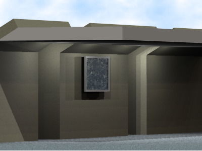

House we’re living in right now has a truss roof. The room over the garage is my office. Sloped ceiling to match the roof. Two dormers. The section of wall between the dormers is the right location for the big ol’ flat screen tv I got after my ancient one died. Got the appropriate wall mount. Needs two studs for the mount. Bracket’s 18″.
All’s going well till I pull out the stud finder. Damn verticals are 24″ oc. That’s why I hate trusses at the moment. I’ve never done _anything_ @ 24″.
One truss, and stud for the wall, is centered on the tv wall. I figure I need to add a brace on either side of that stud reaching the neighboring stud, kinda like what goes behind a pedestal sink. Which means I gotta get into the wall. I can go straight through the front, through the interior side wall of the dormer, or possibly through the garage ceiling beneath.
Which would you pick? Any other ideas?
Thanks.
I'd pick the easiest one that would get the job done. I agree with your idea of simply placing plywood behind the drywall but from the pic you've shown I couldnt tell you which way is the best way to go.

Yeah, I had the time to get behind another part of the wall, and from what I saw, it's likely that the verticals on the walls are part of the truss, and not a separate pony wall (which they probably woulda framed @ 16). I have zero intention of messing with the truss.
