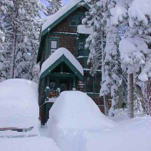

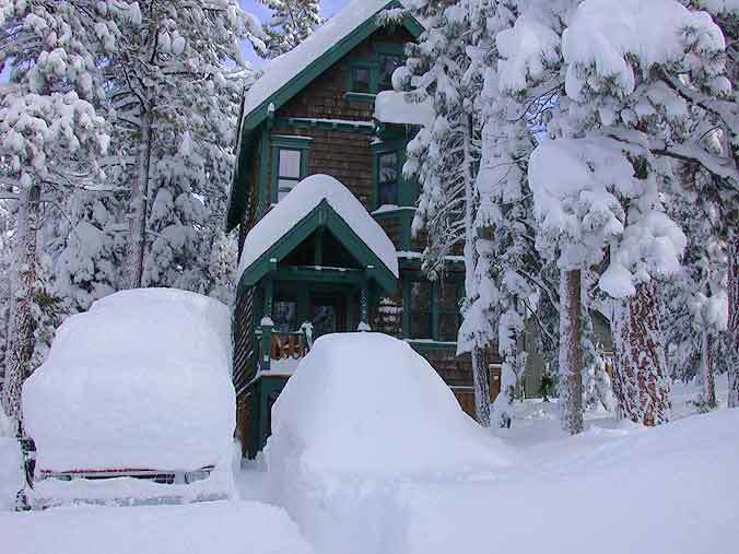

  7. MikeCallahan | Jul 12, 2005 06:31am | #27
    In the Tahoe basin they are as anal as it gets. Height limits are strictly enforced. When you are planning your structure you can get a set of guidelines from the building dept. The height limit is based on the slope of the lot and the pitch of the roof. There is a chart to refer to. My house is on a 16% slope and the pitch of the roof is 12/12, (45 degrees). According to a chart that is on the guidelines I can go up to 40'. That seems high but it was OK'ed by the plan checker and I went ahead. I built a tower. I can see the lake over the trees. I am about a foot under 40 feet.
    Mike Callahan, Lake Tahoe, Ca.
      BillHartmann | Jul 12, 2005 06:47am | #28
      "According to a chart that is on the guidelines I can go up to 40'. That seems high but it was OK'ed by the plan checker and I went ahead. I built a tower. I can see the lake over the trees. I am about a foot under 40 feet."Yes, but what happens when the roof is covered in snow and that pushes you over the limit.
