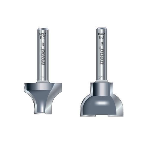

I’m trying to find a set of router bits (or shaper bits) that will cut a traditional ovolo profile for window sash.  Seems like someone’s gotta be making them, but all I can seem to find on the net is the ogee style.
Attached are pictures to define what I mean by “ovolo” and “ogee”.
(The problem with the attached ovolo set is that it doesn’t have a built-in straight cutter for the glazing rabbet, and I don’t want to have to make two passes due to the inherent repeatability problems.)
Does anyone know where I can buy an ovolo set?

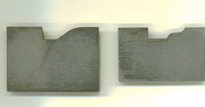

            Some of the old sashes that I've seen have been sort of an inverted V with the tip cut off. Others have been some variation of the ogee.
            Here's a pic of the two sets that I have, both are taken from old sashes, the set that I have for an old house that I own in Iowa is in the shaper at that house, they are the inverted V that I discribed above.
          2. DougU | May 23, 2006 04:28am | #10
            Crap, I forgot to post the pic
