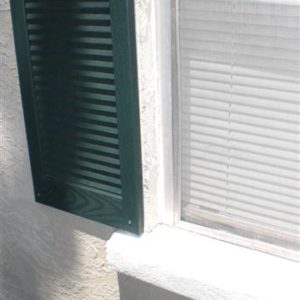

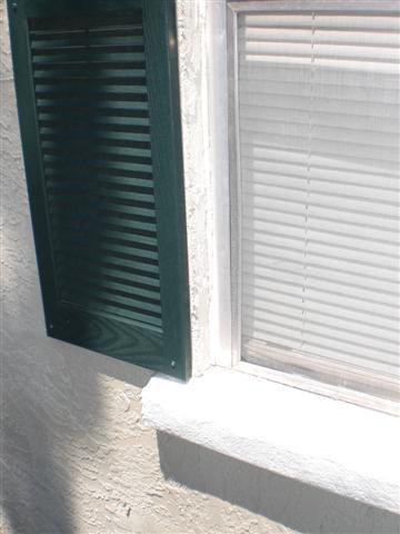

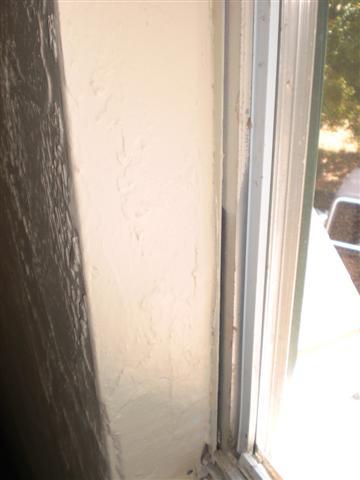

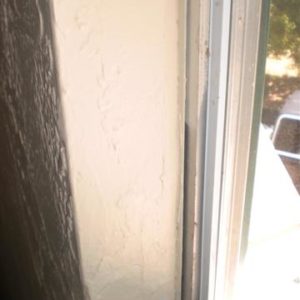

Hi,
I have a property where half of the windows are leaking around the edges. The house is a stucco/frame. The water seams to be getting between the stucco where it meets the window. I tried caulking it but I think it’s just too bad so I decided to replace the old windows with vinyl. I just need to know how to install them correctly in this particular situation. Hope the pics help.

  1. GRCourter | May 11, 2009 03:58pm | #1
    It looks like you have aluminum windows in the openings now and that they have a nail fin.  I remove the glass, take a sawzall and cut the frame extrusions as far back as possible in the middle of the opening and pry the frame out.  In 90% of the aluminum windows that I have replace the installers used a couple of 8d nails in each side and either the nail will pull out (especially if you have had water leaks) or the flange will pull right thru the nail.  Make sure that you use a block of wood on the stucco to minimize cracking.  Yes, minimize cracking because you will have some stucco patching to do.  When you set the replacement window I suggest that you use  Geocel 2300 sealant.
    1. MBaybut | May 11, 2009 04:12pm | #2
      Thanks for the quick response. I just replaced all the windows at my home, which was stucco block. I had to chisel most of the stucco from around the frame to get the frame out and the new one in so I'm anticipating a bit of stucco work. I'll find out when I get the old one out, but I think the sill may need replacing. The water is getting down there and actually running down the wall cavity to the window below. Should I put some kind of flashing where the window meets the sill?

      2. GRCourter | May 11, 2009 05:06pm | #4
        I have been repllacing aluminum windows for more years than I wish to count.  If the sill is stucco and solid (no cracks) I have been 100% successful by using Geocel 2300 sealant around the window as it meet the stucco/sill.  There are a couple of other tri-polymer sealants out there, but I have never seen the reason to change.  I have been back to jobs that I did in the early '90s and have never found sealant failure.  I have seen flashings that have warped and or corroded, and even if you use a flashing you still have to seal the flashing where it meets the window and the sill.  2300 is not cheap, about $5.25 a tube retail but you only buy it once.

    1. MBaybut | May 11, 2009 09:28pm | #6
      I don't have the window out yet so I'm not sure exactly how they're put in. I'm presuming the standard sized window was fixed into the rough opening and then the stucco place around the frame. Can't use the opening without the stucco removed, it shrinks the opening by about 2"

  3. migraine | May 11, 2009 11:03pm | #7
    I will ask this first...
    do you know for fact that the windows are leaking at the stucco to window frame, or the water infiltration from somewhere else and just finding it's way to the window opening?
    Most of the leaks that I have found are from the outside edge of the flange that is behind the stucco, or farther up the wall
    Just replacing the window may/may not fix your problem.

      1. florida | May 12, 2009 08:25pm | #10
        Your house looks like stucco over frame. Is that correct? If yours is a typical 25 or 30 year old Florida home your windows won't have any fins. Remove the screws from the inside, raise the bottom sash, get a pry bar under the bottom center and bend the aluminum up. That will pull the sides in enough that you can work the bottom out and get a bar behind the upper sides. It should come right out.

          1. florida | May 13, 2009 05:45am | #13
            If you're prepared to do battle with the stucco you knock it off all the returns, pull out the lath, install flashing across the bottom, install the window, flash the sides and top, re-nail the lath, stucco, prime, caulk and paint. It's tedious but not really that bad on smaller windows like yours.
