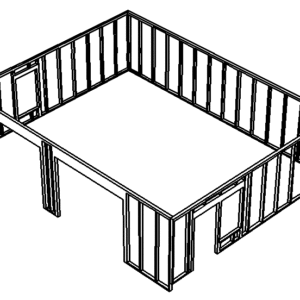

We are doing the ‘crete work now for a little garage job, and our lumber yard guy would like us to try it panelized.
Here is a pic of the wallframes.  Walls are 2×4, 24″ centers, single PT bottom plate, doubled top plates.
The front wall with OH door openings is 8′-3″ high, and the sides and back are 7′-3″ high.  All studs must be cut from 8/0 material.
How long do you think two efficient carpenters will take to stick frame these walls?
    jonblakemore | Nov 08, 2004 10:28pm | #1
    4-7 hours, depending on site conditions.

    BossHog | Nov 09, 2004 12:07am | #2
    Looks like it's about 24 X 28? You don't give dimensions.
    Kinda depends on how much other stuff they have to do.
    Like are they putting a treated plate down first?
    OSB on the walls?
    FWIW - I never quoted panelized walls on stuff that small. I just don't think it's worth it.

  3. JonE | Nov 09, 2004 12:59am | #3
    Depends.  How much more does the panelized version cost than the unpanelized version?
    I'd say that, under good weather conditions and all materials being on site, a pair of good carpenters could have that framed in a day, including the sheathing.  Doesn't look that difficult.  I'd have the slab poured and the plates set, and then frame it all up on the slab and tilt it up.
    My father-in-law opted for the panelized route, and it was crap to say the least.  He regretted it because of the obvious lack of quality.  The panels were not square, the materials were questionable (what looked like reject studs) and the window openings were in the wrong place.  Not to mention, the rough opening for the overhead doors was too tall to fit the doors that the lumberyard supplied.  They didn't bother to check their own doors before they had the panels made.
  4. blue_eyed_devil | Nov 09, 2004 03:39am | #4
    About an hour and a half as pictured.
    The rear wall is 15 minutes, including coffee and cutting the studs.
    The sides are 15 plus 10 minutes for the header. That includes 4 minutes worth of debating what the rough opening will be.
    The front wall is another10  minutes plus another 10 for the jacks. I'd order out that header in one piece, even if I intended to have two separate openings. I'd order a 20' header and run it by both doors. After standing it up, I'd add the center jacks (another ten minutes).
    Lets see, 15+30+20+20+10=one hour and thirty five minutes!
    For me, that would be very close to $100 worth of labor.

  5. MrBill | Nov 09, 2004 04:17am | #5
    Gene,
     Myself and one friend / helper framed and  put up the walls and set all the trusses on my 24 x 24 detached garage in a one day, and it wasn't really hard work.
