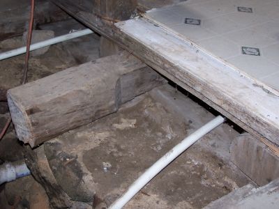

pope78 | Posted in General Discussion on March 30, 2006 02:04am

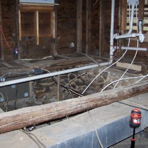

We’ve gutted our 100+ yr. old kitchen and cemented the crawlspace underneath. We pulled up a lot of floors, underlayment, etc. to get the cement in and find out what was going on with the really wavy floor. We had to take out some of the timbers that were used for joists because the were warped and some were not even secured and just moved side to side anyway. What we’re trying to figure out is how to put the new joists in when the walls rest on the existing timbers. If we fit the new joists under the wall they will have to be only 4 in. We know that is not enough to support a floor and at least want to use 2×6’s and a beam underneath to build the floor. A friend with carpentry experience told us to run a board screwed to the level line around the wall and hang the joists on that with a beam underneath. Is this too much weight pulling on the wall? We’d rather not make the floor that high but if it’s our only option we’ll live with it. He also said if we take the timbers out we should put a board underneath all the wall studs to help with the weight of the wall. The kitchen is about 11 ft. wide in the direction the joists would run. Is it a bad idea to use 2×10 instead and notch them to rest on the foundation walls so it doesnt raise the floor? Does notching make you lose the strength of a 2×10 so it’s only as strong as what’s resting on the foundation ( about 4 inches)? Are there any other options? We have to get this floor built soon as we have to walk on it to get to bathroom, kid’s room,etc. Any help would be appreciated. I’ll try to put a picture too. How do you paste pictures right on the post? When I right click the mouse to include the picture it won’t let me choose paste. If anyone knows please let me know so I can post pictures of the floor also. Thanks ( I’m new here)

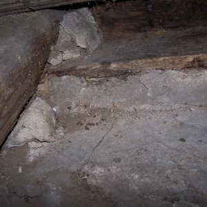

    1. pope78 | Mar 30, 2006 02:35am | #3

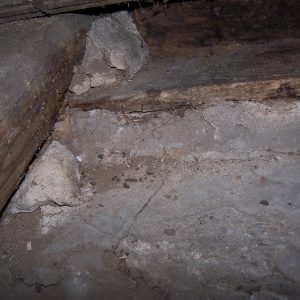

      I'm trying to figure out how to put pictures on here still,but I do have 'em! The top of the foundation is not level at all and looks like field stone with some mortar. It's pretty crumbly in some spots. Can you bolt to a foundation like that? The walls are anywhere from 4.5" to 5.5" from the foundation depending on what part of the room you're in. (very unlevel obviously) Also there is a board underneath some of the timbers which I think may be called a sill plate. Some places dont have it (either it rotted or was never under all of them, I'm not sure).

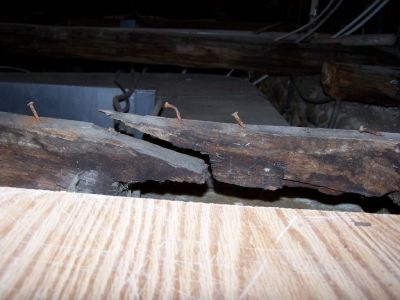

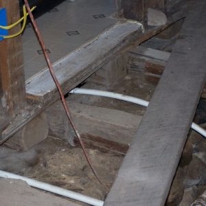

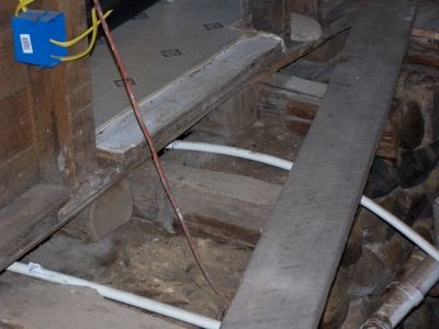

          2. pope78 | Mar 30, 2006 05:57am | #9
            I hope this works and you can see the picture. I still can't figure out how to copy and paste it right on the message but I'll get it sooner or later. I have many more pictures if this one doesn't show the problem well enough, I just have to figure out my picture and browser programs a little better. Another question I have is whether or not you can just use joist hangers and a beam if we do it that way. Does that mean all your floor weight(appliances, etc.) is supported by metal hangers? Thanks.
            zak | Mar 30, 2006 06:52am | #10
            More pictures would help, doing them as attachments is fine. embedding them is just a nifty trick.
            How far would these span? it looks like maybe a 4 x 6 timber in there now. I suppose there's always the option of putting in timbers again alongside the old ones, but that's a lot of work. Are the beam ends and the rim joist solid, no rot?

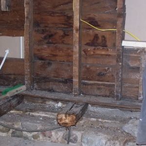

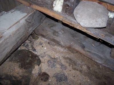

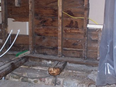

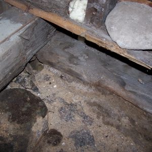

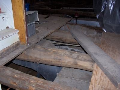

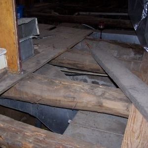

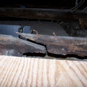

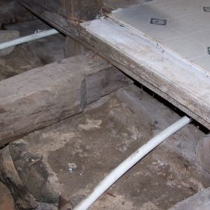

            Some more pictures. The one (dinkit) with the threshold in it is the dining room. We'd like them to be on the same level but what would you use, 4x4's or something? Would smaller floor joists be enough support? I asked before about notching 2x6's but still haven't heard anything yet. Does notching the joists a couple inches on the foundation wall make sense so it is level with the dining room, or does notching it make it only as strong as a 2x4 since there would only be about 4 of the inches actually attached to the foundation wall or ledge? Not much experience with framing, foundations, etc. and a contractor that looked at the floor before we took out timbers and wood floor said even if he did try to level it(before we decided to gut completely), he's busy on jobs till July. No way we can get around the house with three little ones and no floor till July. We're going to do it ourselves. Lots of fun. I just don't want to cause any structural problems with the walls since they are built on the timbers. Too late for the ones we already took out. thanks.
            zak | Mar 30, 2006 09:28am | #13
            I think at this point you may want to talk to some other contractors, and see about getting some experienced help. You could get away with notching joists, but they're not very strong that way, and more importantly, if the foundation is as crumbly as you say, that may need to be addressed. You say the sill plate has rotted out in some places- the whole house may not be on solid footing. It's real hard to tell from my side of the computer, but I would urge you to figure out the whole problem before you patch a little part of it. Where are you, by the way? you can click on your name on the screen and edit your profile to give us more information about yourself.zak

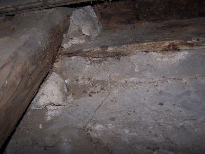

    1. pope78 | Mar 31, 2006 01:51am | #17
      We had a builder check out the foundation before we bought the house a year ago and he said it was fine, been here 100 yrs. or more and still standing, not sinking, etc. What I think is crumbling is something that someone added on top of the foundation, maybe to level it or something. It is under the plate and around it. It looks like a layer of mortar or something. As far as the sill plate rotting, the more I keep looking at it, the more I think it's just missing in areas, not actually rotting, wet, etc. I will attach a picture of it so I can see what you think. If everything is sound, I'd rather not jack up the house and mess with the foundation and find some other way to level the joists. My husband says we're putting the joists in this weekend one way or another so I will have him read some posts before we buy the lumber so he can decide what we're doing. I've told him about some of the ideas and he liked a couple of them, so we're really grateful for any info. Check out the broken joist picture. The more floor pulled up, the worse it gets. Ha ha.
      1. philarenewal | Mar 31, 2006 02:13am | #18
        Now having seen it, yeah that's a problem.  Gives me a bit of a headache trying to come up with something.  All I can come up with are two options:
        1. put the joists on the sill plate, and cut a small notch in the very ends of the joists so the wall plate (that is on top of the timbers) slips into that notch.  This will raise the floor height so I don't particularly like the idea.
        2. notch the joists so the can sit on the sill plate with the tops of the joists below the wall plate, but get an engineer to sign off on what they need to look like at the ends.  If I remember right you have a 10' span.  I don't see just 4" at the ends supporting that.   You might need to double up the joists or fasten plywood scabs at the ends.  Don't be afraid of the engineers.  It doesn't really cost that much.

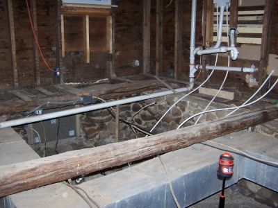

          15. pope78 | Apr 24, 2006 11:06pm | #38
            Rich,I have a few pictures but haven't had time to post anything recently. Kids are back home and we finally have a floor. We had a friend of a friend help us build it who has more experience than we do and that made it go quicker than we thought. My husband helped and we didn't have to pay as much so it worked out well. I don't know if this was a "normal" solution to the issues we had, but this is what he did:Poured four cement posts with a form he built, one in each corner of the crawl spaceMade a "box" spanning from post to post like a rim joist and hung 2x8's on these (the span was significantly smaller than original span because of the posts being "inside" the foundation walls)On the outside of the rim box, attached hangers and cut shorter joists notched out to rest on a new PT sill plate on the foundation wall.(So the notched joists were actually only a few feet in length) We also put new joists in the dining room and leveled them the same as the kitchen since they are kinda the same room.He put two layers of T&G 3/4 plywood sturdi-floor through the kitchen and dining room and broke the seam between the two rooms so it feels more unified. Like I said I don't know if this is the "right" way to do it, but it feels very sturdy and level. We are probably going to run the wall under the center as you suggested for added support, but he'll probably do it when he crawls under there to insulate and stuff in a few weeks. I'll attach pictures to better explain. Thanks for everyone's input. I can't wait to have a real kitchen and I don't think I've ever been as grateful for floors to walk on as I am now.
            We could probably join the circus as much practice as we've had running to the bathroom in the middle of the night balancing on beams.
            Next step is drywall, floor, and someday cabinets....I'll post more pictures if anyone's interested when we're finished.
          16. rfarnham | Apr 24, 2006 11:59pm | #39
            Good solution! Thanks for the update! Congrats on the floor, I know how you feel. I still have open joists in my retrofit. It's getting pretty old.-Rich
          17. Danno | Apr 25, 2006 02:47am | #40
            Looks like a good solution. Nice job! Thanks for posting what you did and the pictures.
