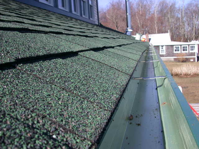

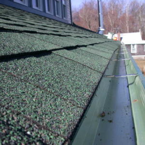

    here's a 5" gutter with  the fascia hangers ( and SS. screws )

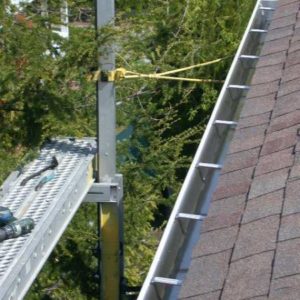

     and here's a 6" gutter  we installed in March

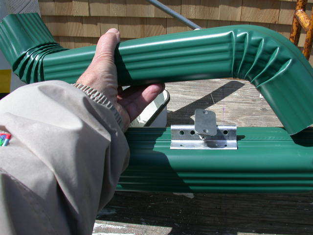

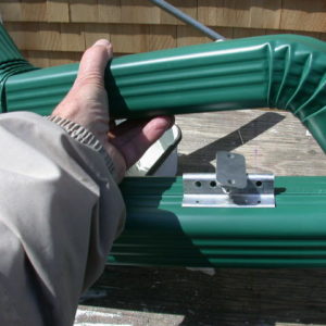

        downspouts... BTW.. here's the adjustable hanger we use on our downspouts... one piece rivets to the back of the pipe.. the other screws to the building.. much neater than the old nail-on straps..
