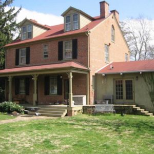

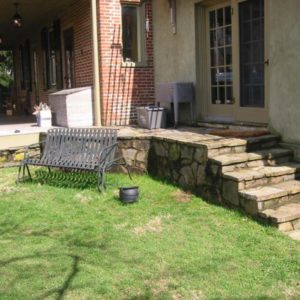

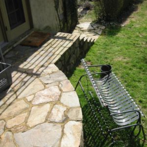

I’ve been asked by some friends to build a railing for their stone patio/steps, and am not sure what would be a good overall design that would fit in with the style of the house, and the space limitations involved.
The attached pics show that it’s an early 19’th century Pennsylvania farmhouse with a recent addition. The railing needs to span the space from the porch post, along the curved patio edge, and down the steps. They would like it to be made from a wood that needs minimal maintenance and can be left to weather to gray like the narrow attached arbor (hard to see) over the double doors in pic #1. I haven’t checked to be sure, but I guess it’s either teak, or mahogany. They also don’t want any railings on the rest of the porch, just in the area of the narrower patio and steps.

1) Any opinions on a reasonable design to transition from the painted porch post on one end, to the stone steps on the other. Weathered wood  could look good over the stonework, but seems like it shouldn’t actually attach to the painted post. Maybe the railing should just stop at the end of the stone patio. I think the porch height is just under 30″, so it might not have to run all the way to the post.
2) What’s the best way to anchor a hollow boxed newelpost to the stonework?  I guess that it would need to have a square steel tube core that would be anchored by a welded flange and anchor bolts, or would a pipe set in a drilled hole be better? Probably something I haven’t thought of.

    sledge | May 15, 2007 02:23am | #1
    Hi,
    I love stonework but in this case the stone almost looks out of place. I would look into extending the existing deck and removing the stone work. This would allow you to extend the same look over the whole deck.
    I  feel what's in place now does not fit and if you try to add any more to what's there you may wind up with an expensive mess.

  2. Piffin | May 15, 2007 11:54am | #3
    To my eye, that calls for a metal railing. Powder coated AL styled like wrought iron.

    1. DaveRicheson | May 15, 2007 12:43pm | #4
      I agre with you . Powder coated Al. railing at the stone work and maybe even add it between the post on the wooden porch area. Might kind of help tie the disjointed designs together a little.

  3. woodguy99 | May 15, 2007 02:13pm | #5
    I'm with the other guys--
    The front porch steps could use a nice wooden boxed newel.  The addition has sort of a mediteranean feel and would look best with a more delicate, metal railing.  Mixing materials (wood and metal) for effect can look great, but not on that house.
