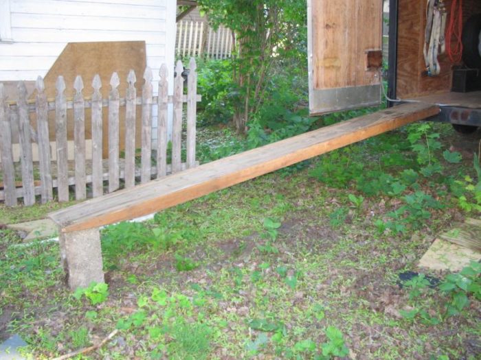

The car loads into the trailer on some pretty simple ramps I whipped up in a rush one day- 2 x 10s with 2 x4s on edge Gorilla glued and screwed to the 2 x 10s. Overall length is 12 ft. In the picture, you can see (it’s propped up on a cinder block to approximate the usual ramp level) the bevel cut at the tip.
Trouble is, the darn things are REALLY heavy for my friendly volunteer helpers, and are one use items, as they are “U” shaped on the bottom.. If they could be used upside down as long spacers/ramps on the flat ground at the track, I could get a jack under the car much more easily. Filling in the 9.25″ x 2″ void would make them even heavier though. They handle the cars weight easily though.

    i could see a simple 8" metal  C perlin with a 1x2 metal tube welded down the center (bottom side)  and a few flat metal straps welded every 12" across the open part of the C...  paint the top side with some gritty paint for traction if it was wet and i think you might save a few lbs over your wood units...
