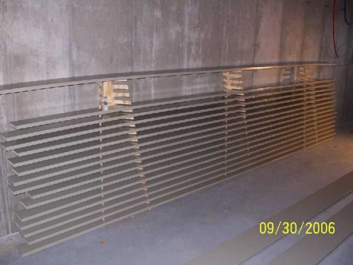

jhausch | Posted in Construction Techniques on October 1, 2006 03:53am

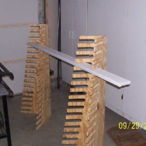

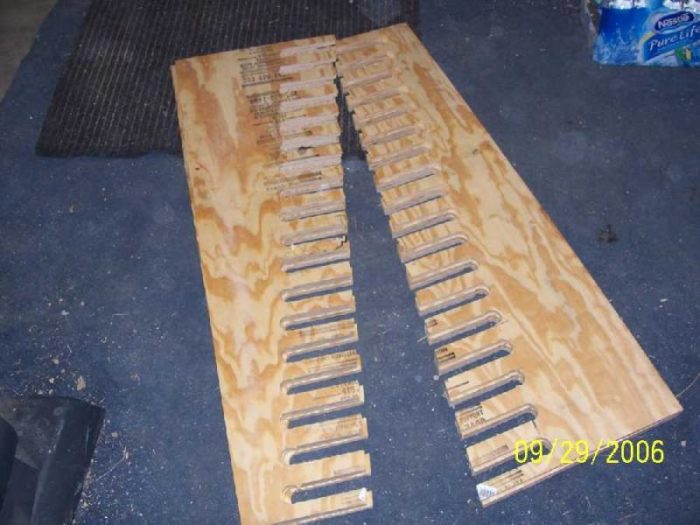

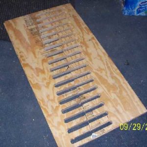

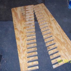

Prepainting the trim for the house.
Running out of floor space in the basement.
Came up with this idea.
The first pics are the construction process, the last is the rack in action.

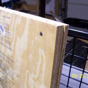

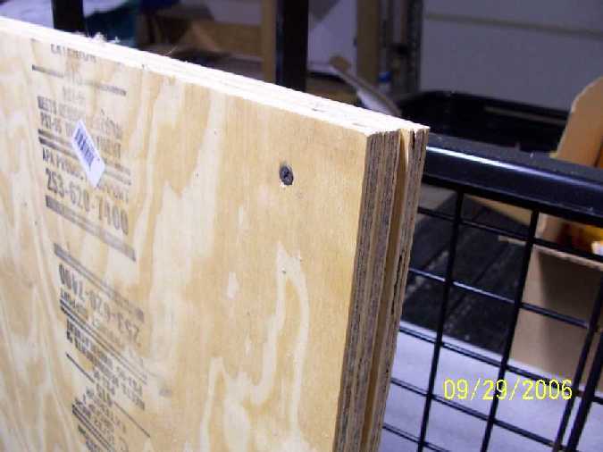

Not clear from the pics is that the halves are held together with a couple of $1.50 hinges per rack.  If I were building a pair to keep as a pro, I’d use machine screws, washers and nuts.  Those 1/2″ #8’s are not going to last forever.

      jhausch | Oct 01, 2006 04:27pm | #2
      Thanks,
      I forgot this pic from the process - 1-1/4" self feed bit.
      I cut the slots with a circ. saw.
      Important note - Distance from short edge to first slot must be the same on both ends since one side is inverted at assembly. (edit, prospero does not like the abbreviation for assembly.)

        jhausch | Oct 02, 2006 06:11am | #12
        You're probably right about the thread title - I was just trying to be creative.  I almost just named it - "Hey, nice rack!", but thought that would not have been fair.

    one question...do you paint the material while in the rack...seems like you might have shift things a bit as you paint as the arm over the stock might be in the way a bit.

      jhausch | Oct 02, 2006 06:07am | #10
      We are only painting one side and both edges.  The wife rolls, I brush-out, and about every three pieces we move them into the rack.
      I still have not seen the one in this month's issue, but one issue I have with the racks that let you paint and stack on another layer is "what about drips".  I can be a bit sloppy.  Maybe it is less of a concern than I think it is.
