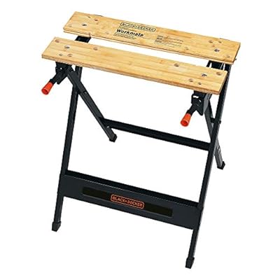

Got ya out-cobbled. Don't have a picture, but last week I used one of these:
Picture it on its side, and you've got it._______________________________________________________________
