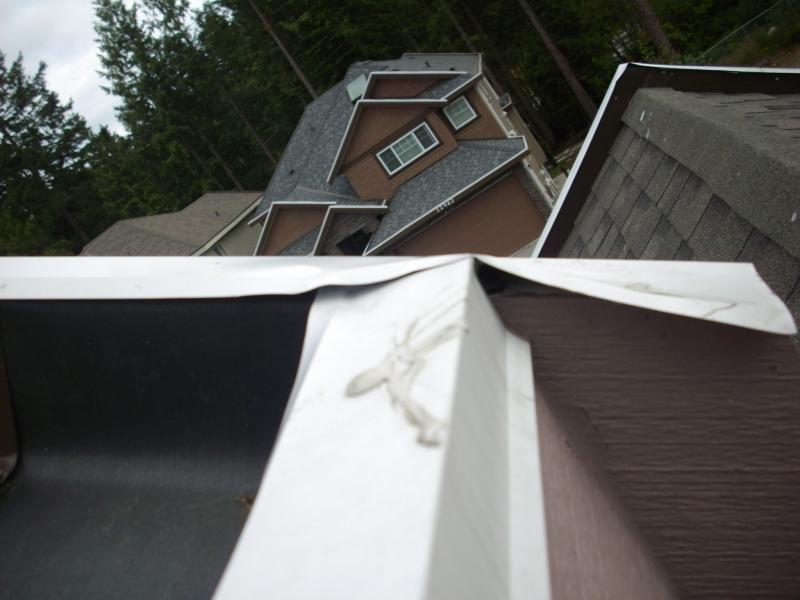

The installed flashings to protect the intersection of the 2″ x 10″ fascia board and EPDM rainwater gutter membrane is rather suspect. Are there drawings/photos available which detail the correct methodology for this install?

That is the worst use of aluminum premade fascia cover I have ever seen.

Knick suggests there's built-in gutters up there.
I see alum. fascia cover, covering something.
In the background house, it looks like mini parapets atop the rakes which I suppose could be considered guides to channel water down the roof into those built-in "gutters".
There appears to be some rubber lined somethings that might be capped with haphazardly placed white aluminum fascia..........

take a look at the background in the first picture
It seams an odd detail on top of the rake, using the same material.
It appears to be used in the house across the street as well.
(sorry, tried to resize the picture in the Image Box, but that don't work neither...........................)
I think this is builder/designer's delusional idea of crisp roof line. Guaranteed to be catch all for whatever the nature throws in it, only can be cleaned by expensive gutter service, complete failure in flashing details. You said it, the eave facia flashing over the roofing shingles! That is what I was designing when I was a teenager, completely naive about the nature.
To the original poster: I am somewhat experienced carpenter. One thing about water is it can defy gravity by wicking, freezing, wind blown, and plain coming down in buckets. Outside of the house, siding, trim, can dry, but framing under the siding, trim may not dry out because it is covered. Point of roofing, sheet metal flashing, paint is to keep the wooden parts of the house dry. Eave should not, as in the photo, have a wood sitting on top of it. When rain goes under it, it will continue to wet the framing, all hidden behind the sheet metal facia cover. Caulk can not fix it.

It basically needs to be handled like an EPDM curb. See, eg (just what Google found): http://www.carlislesyntec.com/download.aspx?id=1665&fileID=1003 , or http://www.genflex.com/uploadedFiles/Technical_Info/E-1.05.pdf , or http://www.genflex.com/uploadedFiles/Technical_Info/E-18.02.pdf , or http://www.lottesroofing.com/RoofDrawingsDetails.html , and several others (including videos) . The EPDM manufacturers should have manuals of some sort available, and the above web sites have other drawings for other details.
But note that due to the high likelhood of full overflow of the curb, you need to be extra carefull with all the joints -- belt and suspenders -- and run the membrane from the roof up as high as possible.
And get a signed release from liability for that crummy design.
This is one of those things that never should have been built as noted above. But, since it's a "gutter", not a parapet, the membrane needs to extend over the top. If the gutter clogs, water can go under the metal cap and get behind the rubber. It still needs a metal cap for cosmetics, but it should be adhered to the membrane.

Hidden gutters are the norm in this developement. The installers did not appear to have an appreciation for workmanship and quality.
However, I had requested some assisstance with drawings / details indicating the correct method of installing EPDM in the gutters c/w the metal flashing cover.

start googling
parapet cap leads you to :
http://www.buildsite.com/pdf/nrca/Base-Flashing-At-Parapet-Wall-With-Metal-Cap-Coping-EPDM-1-NRCA-Detail-325658.pdf
http://www.genflex.com/content.aspx?id=2796
http://www.carlislesyntec.com/default.aspx?page=search&mediatype=literature&doctype=3&sort=doctype
2 of the above have a boatload of detail drawings. Hopefully with your time and energy you can flip through those that help you.
Most of the epdm companies have detail pages that you can access.
Admittedly you might have to adapt what you got to what they picture. Always remember to run product up above the assumed water line-counterflashing is your friend and start at the bottom and work your way up.
