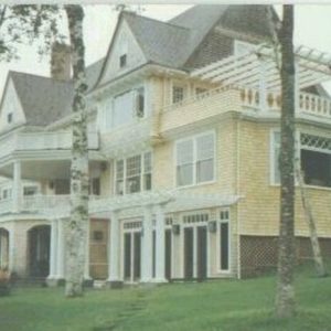

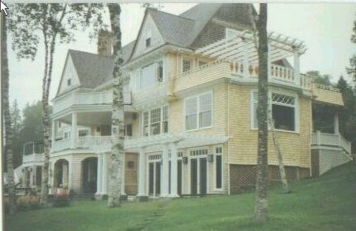

    As I understand your project, if the ground is uneven, you might consider stone or other plinth bases of varying heights to make the columns all the same at say 11'6" or whatever. I post an example of this with photo of granite plinths and ten foot columns at 12" diameter. The plinths can help 'anchor' the poles and keep it from looking like it will take off.

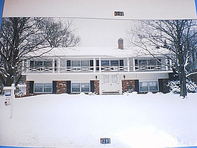

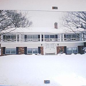

      Sorry about the lapse in time, I'm not always able to log in every day. I am going to try to send the picture of the front of my house again. I appreciate your looking at it and suggesting ways to install the new columns (that will take the place of the old balcony) in a way that makes sense and is visually pleasing on the asymmetrical front of my house.

        Your photo pretty much shows what I was talking about for location with the doubled columns on the balcony. If they werre still there, I'd say just place new ones directly uinder those posts. Now, use similar locations but by doing a scale drawing with reference to your window and door locations you might be able to balance it out more evenly.
        On the balcony, for some reason, you have wide, narrower, wide, narrower great spaces. I would look to balance it by having the two outer great spaces a little wider but both same as each other, then the two central great spaces equall to each other but a little smaller than the outer spaces. Use double columns like shown and don't plant any columns right in front of a window.
        Now, FWIW, IMO twelve inchsquare fluted columns would look best with that house unless you did more in terms of an overall face lift..

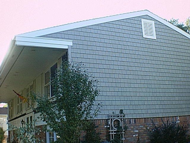

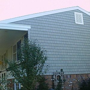

          I have included a photo of the side of the house that borders on the front. This side is finished with the new material.
