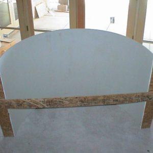

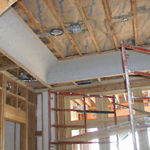

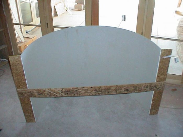

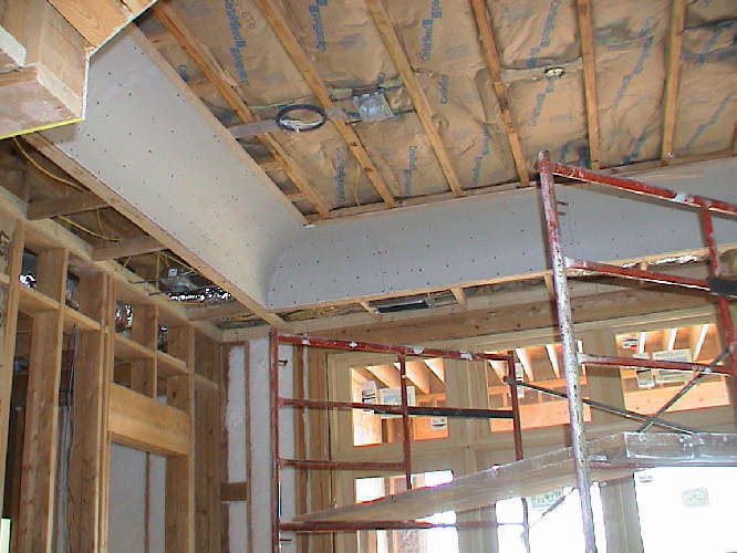

1/2 ” drywall bent to a 35″ radius, for a groin vault ceiling, a couple of eliptical coved inset ceilings also out of drywall.

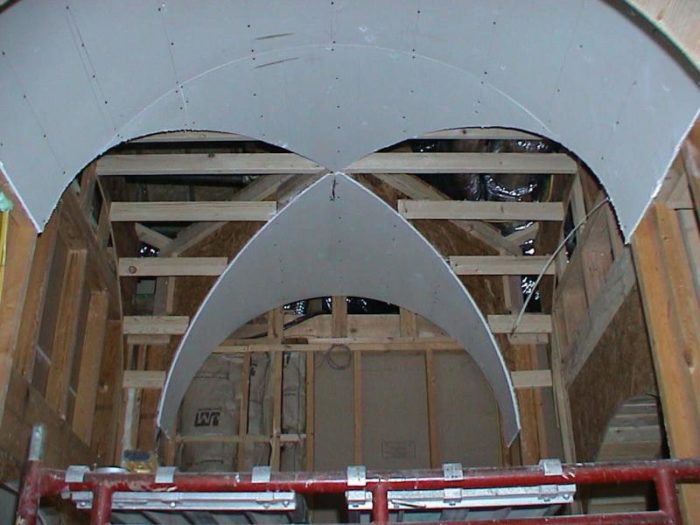

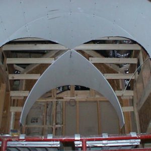

    a snap of the 1/2 " board on the groin vault

    What did you use behind the drywall on that cove for backing?  I see the screws are closely spaced.  I think I'll get to do a cove like that in the house I'm working on.  Do you have any pictures of the framing?
    1. brisketbean | Feb 12, 2003 03:30pm | #4
      Tim;     the frame is just dimension lumber with purlins 6" on center because the elipses are tight. I did not shoot any snaps of the frame
        Timuhler | Feb 12, 2003 05:12pm | #5
        Thanks Brisketbean.  I'll make sure and post some pictures if I get to frame the cove.  Then you can tell me what to do differently :-)
        1. KennDrake | Feb 14, 2003 11:44pm | #6
          I remember some of the vaults that you posted in the old Breaktime Forum. They looked great, and so does this one.
          It appears that more than one radius is involved. Is that correct, or am I seeing it wrong? Do you have any other photos of the groin vault from another angle? If so, please post them.
          Also, it looks like you may have used 1/2" OSB for the ellipses at the intersections. True?

    Dang! I didn't know you could do that with drywall...looks great...did you wet it down and put it over a form to dry?
    Jen
  4. rickshort | Feb 15, 2003 06:56am | #8
    Very empressive, never seen 1/2" board bent so tight.  They sell 1/4" flex drywall now..two layers...for the average person...obviously you don't need it!!
    1. brisketbean | Feb 15, 2003 10:12am | #9
      I use the 1/4 inch for tight bends, but I can bend somewhat tighter than a 35" radius with 1/2, how tight, I don't know for sure yet.

    Ted W. | Apr 10, 2009 03:25pm | #12
    wow, not that's some nice work there!
    Can I ask, how long does it take to do something like that? Just the drywall part, also the crotch vault. Inquiring minds want to know. =)
    ~ Ted W ~
    Cheap Tools! - MyToolbox.net
    See my work - TedsCarpentry.com
    1. bender1954 | Apr 11, 2009 07:13am | #14
      ted it takes me 3 or 4 hours to frame a simple groin vault like that one, and a couple of hours to bend and hang the rock. I frame them with metal now instead of wood, they are easier with metal and come out more symetrical.  john
