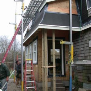

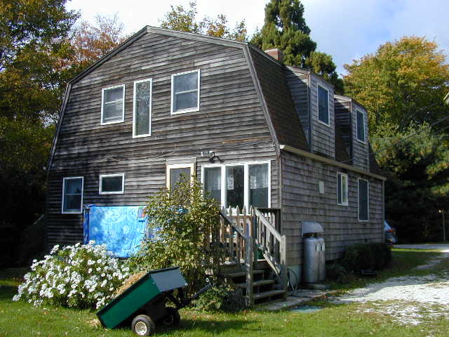

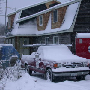

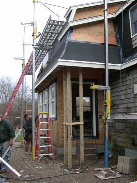

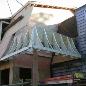

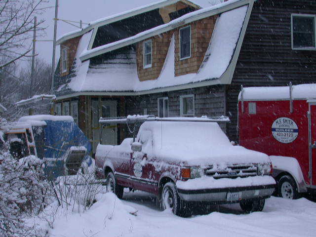

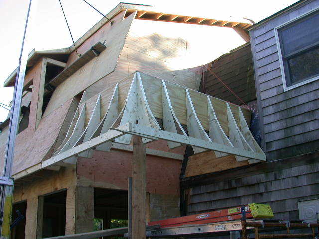

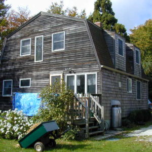

          2. MikeSmith | Feb 07, 2003 06:15am | #23
            been working on a nice little gambrel...doubled it 's size  with a 16' x 28' addition..
            here's a before... and the entry framing .. and some of the exterior
          3. brisketbean | Feb 07, 2003 07:06am | #24
            nice little gambrel, my grandmother had a wonderfull gambrel, some of the best memories from my youth were there. I use plaster only on the domes that don't have planes, and I sub it out. I am a pretty fair drywall finisher and at my age I am not looking to master any trades that I am not already acomplished at, so I aint interested in the plaster work. There are only two kinds of plaster, cracked and fixing to crack, that is a feature that I can eliminate with drywall. I don't come to braektime too much any more, been playing a lot of online chess, there weren't any  people in my circle that could beat me at it, when I started playing on line I found out there are a lot of very good chess players out there, I am getting my butt kicked a whole lot more than I have a taste for. When i get some finished pics of some more ceilings I will post, but these big houses just move so slow, the ceilings I am doing now, I bid a year ago. Be blessed Mike
          4. MikeSmith | Feb 07, 2003 07:18am | #25
