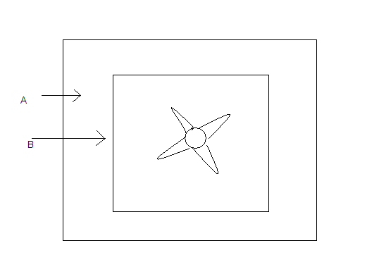

How to finish this (simple drawing)
Sailfish | Posted in General Discussion on August 14, 2008 05:40am
This will be a faus drop ceiling done with drywall (arrow A)
I haven’t decided whether to go with 1/2″ or 1″ , but how is the edge (Arrow B) finished?

  1. Jim_Allen | Aug 14, 2008 05:44pm | #1
    A and B are pointing to the same surface on the drawing I see.

  3. Piffin | Aug 14, 2008 05:53pm | #3
    OK, it finally loaded.
    Drop an inch and run a molding around the drop to give it definition
      Sailfish | Aug 14, 2008 06:40pm | #4
      OH that would be perfect.
      why didn't I think of that.
      Just offhand, what about with mud? Could it be finished with mud and or some sort of outside corner piece or something?

  4. dovetail97128 | Aug 14, 2008 06:50pm | #5
    What do you want to see?
    A clean sharp edge at the drop in elevation? I would use metal "J" channel. Tape and finish , provides a crisp , clean edge without any added carpentry work.
    You could also use bullnose sheet rock corners and have a softened look if that would match the rest of the finish detailing in the house.
      Sailfish | Aug 14, 2008 07:29pm | #6
      THanks.
      I've narrowed it down, sort of.
      It'll either be the clean sharp edge (w/metal j corner**) or the wood.
      I like both, and both will be suffice.
      ** I knew it was called somthing, my drywalling knowledge is thin at best.

      1. Piffin | Aug 15, 2008 02:50am | #8
        "I knew it was called somthing,"Ha haIn wood trims, a transition piece is called a bollection molding
  5. beachguy1960 | Aug 16, 2008 06:17pm | #10
    Have you looked at the Trim-tex products? I'm in love with them! If you can dream it, you can do it! Check out drywallart.com
