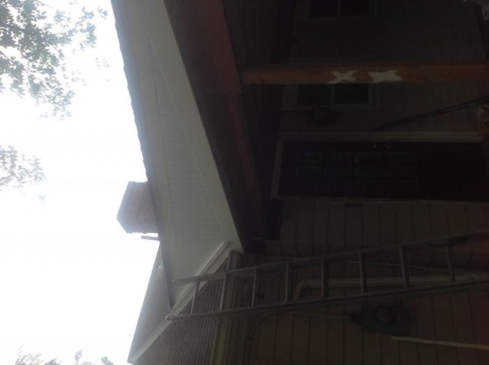

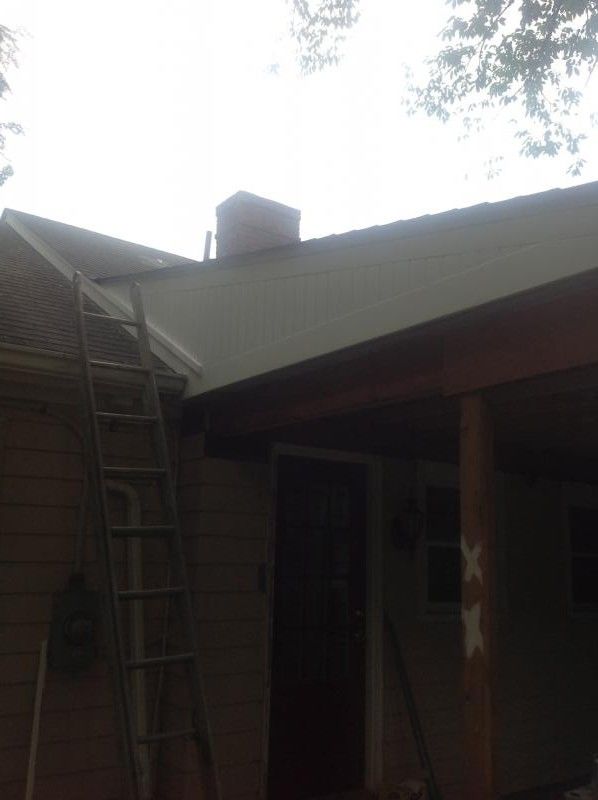

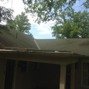

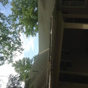

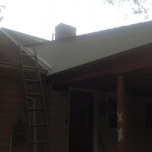

Well, my project is almost complete. I added a 3:12 pitch roof which replaced a 3/4:12. Now for finishing touches, I would like to build some arches. The two supporting columns are going to be something like 8×8 permacast columns. But I’m willing to learn how to build my own columns. I would also like to learn how to build arches between columns and the house. I know I will have to build the beams out to 8″ that way the top cap on the column is flush. Any ideas and instruction would be great. Thanks guys.
Don’t know why my pics are sideways. I’m using an ipad

    Find the pictures and turn them right side up.  Unlike your ipad, we cannot turn the computer screen sideways and have them shown right...................

  2. DanH | Jul 18, 2013 06:55am | #2
    How's this?
    File format File format File format
    1. Aspa | Jul 18, 2013 03:34pm | #3
      Thanks for fixing the pictures.
