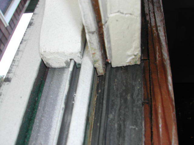

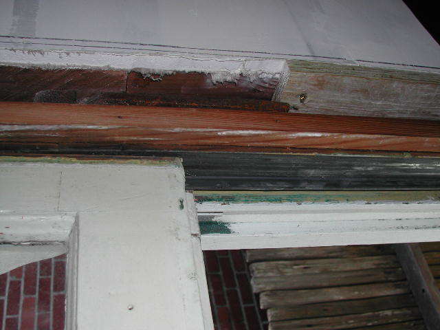

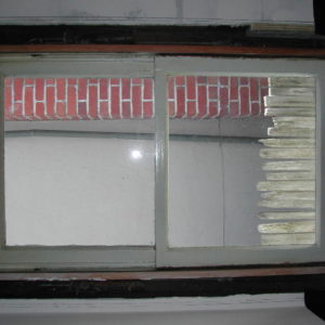

Hey Guys,
Rehabing a 1920s/30s bungalow here in the SF Bay Area, and I have some original double hung windows that I would like to replace the sash cords on while I have the trim off.  Only problem is I can’t for the life of me figure out how to remove the actual windows from the casement…there’s no parting beads to remove as I have typically seen with this window style.  Anyone seen these and have some suggestions?

    You need to pull out the metal liners.  Oftentimes they're held on by very small gauge nails.  You work the nails out (all) and then raise the lower sash all the way up.  Gently pry out the bottom of that metal liner, working it out and down as you go.  Same for the upper sash.  Repeat the process backwards to re-install.  Should have the same wood access plate behind the metal.

        Believe me, you'll cuss and moan, bend the metal a bit and probably cut yourself.  The little nails will get lost, the panel will be in too tight and don't use nylon rope.
        Take your time, work it.  It'll come.  You don't want to booger up the metal so it'll catch on the sash later.  Small needle nose pliers help re-insert the tiny nails.
        The red devil thin pry bar is the ticket on this project.  Maybe even mini vice grips to grasp the high part of the metal(down low, to pull it out).  Don't crush it too much, a bit won't hurt.Remodeling Contractor just outside the Glass City.
