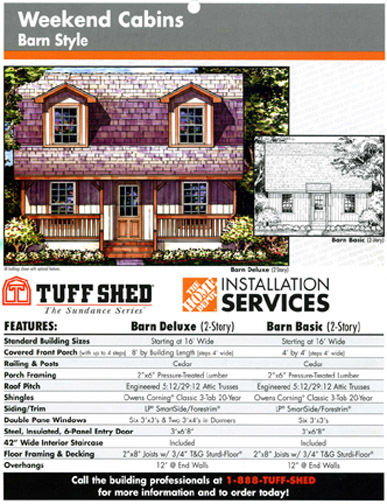

How would you start an 8’x32′ Porch?
I have the 8’x32′ concrete porch floor finished, and the walls framed for the first story.
There are six embedded 3/8″ foundation bolts across the porch’s front edge. I have four 6″x6″ turned posts, mounting them to the porch floor with the one bolt would seem to be a wobbly feeling.
Both pressure treated 4×4’s and 4×6’s that are 16′ long for all the framing members. Would attach the members with Simpson’s?
The porch decking is 5/8″ Cool Ply that matches the gambrel roof decking.
Below the picture on the left is the model I’m building.
How would you start and construct the porch with a 2′ over hang on each end and on the front?
Thanks for your experience and input.
Bill
