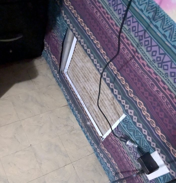

Is 18×12 filter size return large enough? 773 sq ft house. Im getting quotes to replace furnace and condenser w\heat pump. Several quoters have said 2 ton & that existing 18×12 is too small. I was going to cut larger the existing hole which was originally cut thru cmu structural wall. Not a task im looking forward too. I’m looking at larger return vents that id need to buy & most have grills that block up to 50% of airflow. Air handler manufacturers must consider that when specifying return size. My 18×12 has no grill. So. I think it can safely be 50% smaller then manufacturers specify.
Questions I know ill be asked:
This hole was cut thru structural cmu wall when central oil furnace heater was added to 1952 house before i bought in 1986. Sometime after that, but still before I bought, central cooling was added.
In 2002 the condenser started over heating & I was told it needed to be replaced. Contractor installed 3 ton and used that existing hole. After he left I read the install papers & it specified a larger hole. Later I learned 3 ton was too big. A few years later I removed the grill. This also makes it easier to see if it’s dirty. It’s worked fine all these years, but I know I use it much less then most Floridians.
I think im ok leaving it at 18×12 since no grating to restrict air.
Your thoughts?

    Last contractor actually said he wasn't sure of size needed & will get back to me. 2 days later he said "I have an air duct calculator and a 12 x 18 opening will move 1400 CFM. A 2 ton system is 800 CFM. If you add a filter and a front grille, it drops to 900 CFM. It is fine for a 2 ton system but too small for a 3 ton system."
    Your thoughts?

    Done that. Filter opening 16x20 & 18x18.
    Both. Only use when im uncomfortable. Set it 2 deg lower or higher then ambient.
    3 ton always felt fine, but ima odd animal. J method says 1.5
