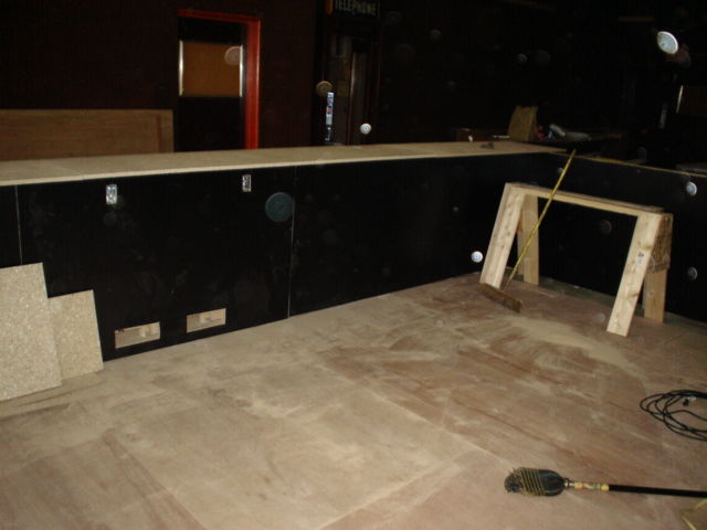

Not a very good pic, but you can see my saw horse made in Pennsylvania.
I'm with blue though, I'm not sure what the weight rating is.

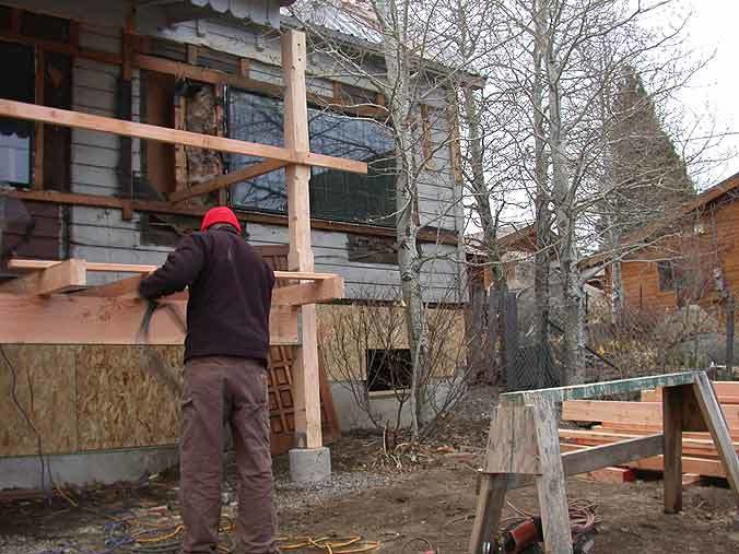

This pic shows half a horse. I'd be willing to bet that a pair of them would easily hold a ton without any modifications. They are built out of rs spruce 1 x 4 legs and spf 2x4 tops. They take five minutes. The jey feature is that they MUST be built to receive the framing square. I haven't met a rookie yet that has built them the first time to receive the square. Of course, they get a failing grade then and aren't allowed to be a "traveling" horse. I cut them in half at the end of the job.
If I add a simply 1x4 spreader on the legs, I think these would hold two tons.
Anyone want to do a load test? I'll put a bunk of studs on mine if you'll do that to yours?
Incidently, that worker is a fairly new hire from Guatemala. He is awesome. He's my table framing partner.
