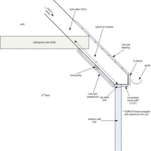

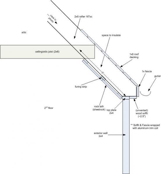

I’ve asked questions on and off about the theory surrounding insulating attics here for a bit and gotten some great responses, but since the time’s come to decide (and I still haven’t) I figured I’d offer this more directly to the group.
How do I insulate the attic in this diagram & pic? The sloped area is currently filled to the sheathing with cellulose (not dense) & kraft faced FG. Cellulose on the rest of the attic floor. Only 1 gable vent.
We’re re-roofing in spring so we can add a ridge vent then. I haven’t found any roofer willing to put in soffit vents, except for a SmartVent from DCI which I don’t think will work in MA.
I’ve gotten quotes to icynene it and the cost feasible but painful and delays a lot of other projects. Just not sure I like the theory behind foaming the roof so much. And I’m not sure the foamers can do it well.
No mechanical ventilation yet and no a/c. Attic is a walkup.
For a cold roof, I’ve also thought about ripping sheets of XPS and sliding it down the sloped part but that seems like a lot of work – plus I still have to vent the soffit somehow.
Rigid panels on top of the roof is out for many reasons.

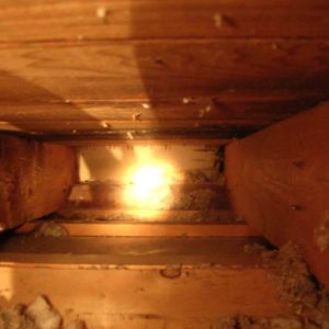

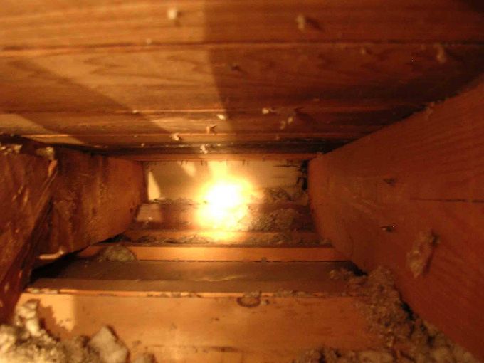

Ideas? Here’s a pic looking down the sloped part.
I actually had a nightmare about this last night, so its time to directly ask the professors what to do instead of just get the theory.
Thanks!
  1. piko | Nov 21, 2005 06:31pm | #1
    Around here  insulation in a 2x6 ceiling would be inadequate - our code is for R40 (=your R32??) - with the exception of the area under debate. I don'tr know if the rest of the roof is of minimal ins'l value, but it might be worth raising that value - and you may be able to get grants of help from your utility co to do so. But it entails adding a new set of 2x, ins'l and sheathing over the existing. May not be the best way, but you may not have thought about it.
    Failing that, then I think I'd be inclined to remove the drywall, put in trays or troughs, then stuff in the appropriate ins'l, and reboard. You appreciate that there has to be an air channel. Oh, it's dawned on me that you might rather place and staple those trays/troughs from the top down, then add foaming ins'l thru small holes in the ceiling...
    All the best...
    1. BobS | Nov 21, 2005 07:26pm | #2
      Thanks for the response Piko. I agree, 2x6 is inadequate, no matter what I fill it with, but we don't have the money to strip the sheathing and sister on 2xs, and resheath. Its less than 3' of the roof, so I'm okay with it being inadequate there and healthy everywhere else. I should have mentioned this in the OP, but we can't rip down the sheetrock. There's a good 1/2" of plaster on the whole ceiling that is curved from the ceiling, down the sloped part, to the walls. It would be difficult and expensive to replace that kind of craftsmanship. Also we are living in the house. I don't think I could convice my wife to rip down the ceiling.
      Edited 11/21/2005 11:48 am ET by BobS
      1. piko | Nov 21, 2005 08:08pm | #3
        OK. As I pointed out, our BC building code allows for reduced ins'l in exactly that area...yours may do too. So, that leaves you with installing trays to the u/s of sheathing , and stuffing some kind of ins'l down afterward. F/G gets bunched up, thereby losing effectiveness, but cellulose blown in should work well, as would foam. Except that only the former is something you might do yourself. Perhaps pushing 6" strips cut off a batt down piecemeal might be the way for you to do it - stuffing one batt at a time would leave it bunched at the top and void at the eave - use a pitchfork or rake so there's a longish handle to save you scrunching up in the corner.All the best...
        1. BobS | Nov 21, 2005 08:35pm | #4
          Thanks,Piko. Sounds like you are a cold roof proponent.As you can see in the picture, there's no backdam to keep the insulation out of the soffits. I supposed I can kindof shimmy one down there - but I'm not sure how to lock it in place. So maybe batts would be better. Do you have any recommendations for a soffit vent? The soffits are really narrow, covered with trim coil, and no one wants to work on them. So I'll have to do it myself on a ladder - looking for something easy to install that works well (aren't we all) since I'm not crazy about ladder work.
          1. piko | Nov 22, 2005 03:56am | #11
            If you're going for foam or spray-in, the subbie will know what to do . Otherwise go with the tray and a dam of f/g batting, shoved in as per my prev note.All the best...
