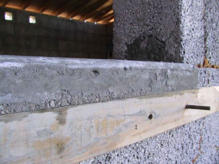

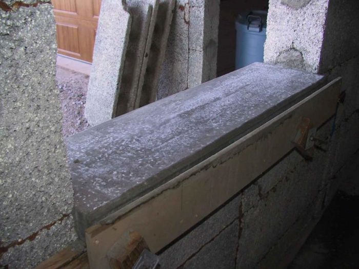

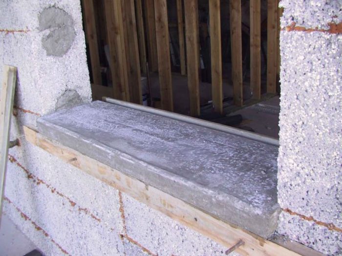

I attached a photo of my handy work. You can see the vertical edge suffers from some aggregate showing – any suggested fixes? I thought I gave the forms ample taps to get the concrete to settle…

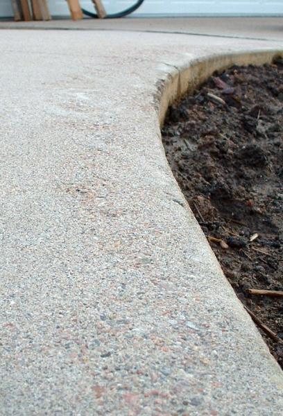

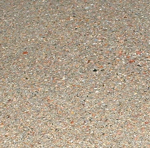

At this point I'd think about what you can do after the fact. If you have some areas that kind of have that distressed look, then go with it.
After all, that is the beauty of concrete. I recently poured and finished a concrete walkway but I didn't want it to look new. So I acid etched it. I took a few applications of the acid with plenty of water to get it off but the results were worth it.
It took off the gray plastic looking cement and left exposed sand.
after you open it up like this you want to seal it well. I used a sealer that was silicone based so it didn't change the appearance. No gloss at all. But water beads right off of it.
You might try this. Make it look like you meant it to be that way.
One thing I remember about reading an article on concrete countertops. They vibrated the concrete by taking a rotary hammer drill and putting the bit on the form.

Cast then away from the building.
Make a form and cast them upside down.
Google concrete counters or give a shout out here to ponytail or waters.
Among others here they have done this type work.
I've cast maybe 100 sills all out of one mold... i've cast them as long as 8ft where they also act as the lintel/header for french door units directly below them... in these i use rebar
but... as was stated you want to cast them upside down... i use white portland and whit golf course sand (very white clean sand) and i use a crushed very light grey rock... almost white....
mine when cast look like polished limestone..
my mold is made out of 16ga sheet metal... it's 100" long and 12" wide (12" works for what i used them for) they are 3.5" thick with a 8" of flat on the top and then it tapers down to 3" on the front edge.... for water to run off... i set my doors or windows to the the edge of the 8" flat...
i cast them upside down... i have a movable block that i clamp in place to make the sill how long i need it... i wax the mold with automotive wax... I vibrate with recip saws... jig saws... or best thanks to another breaktimer a hammer drill...
I______/I kinda what my mold looks like the sides come up over 1.5" and then down 1" that lets my sheet metal mold sit on standard 2x4's which i have mounted on 3/4 plywood.. so if you follow the steet metal it's up 1" over 1.5" down 3.5" over 8" up at about 5 degrees for 4" then up 3" over 1.5" then down 1"...
my mix i use alot of portland... 1 part portland 2 parts sand 1 part rock this is a very heavy portland mix (you can go to 2 parts rock and it'd still be heavy on portland...) but with my mix you can have it much wetter and still be strong...
you can get it very smooth right out of the mold with this mix and alot of tapping and vibrating... OR you can make it look like a porous rock/coral with no vibrating just a few taps and leave the bubbles... nice natural stone look
i play in concrete just about everyday... so yell if i can help

I've used sheet metal...it's ok smooth... but the smoothest i've gotten is using lexan/plexiglass... i get the sign faces that have been removed from large signs from the sign shop... they are all headed to the dumpster... i use the back side that has not been exposed to the sun or painted... with this material i get a VERY slick finish that people think i polished ....

oh yeah i left out while the concrete is in the mold... on the outside edge bottom about 1/2" back from the front edge i put a small groove maybe 1/8" deep on what will be the bottom side...installed.... i leave mine proud from the finished outside wall about 1 1/4" this "groove" acts as a drip edge making water drop off vs try'n to run under your sill... also when i place mine in a bed of mortar... even with the cast in place slope i still put just a little slope to the outside on the whole thing...

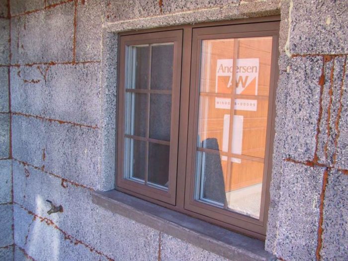

Here are a few shots of the installed windows on the concrete sill.
i think they look good... nice work... they go very well with what you have...
I'm a huge fan of concrete... i mean who else other than God can make a stone?
<g> P

Be aware that you can take a grinder to concrete to remove flashing and other errors. It works really well on newer concrete.

To refinish your sill all youll need is a bag of plastic cement (with no added sand)also Thinset will work. You mix it to the consistency of mayonnaise and putty it on like drywall mud. With a paint brush and water smooth it out. The hard part is to keep it from checking and cracking. You must soak the surface real good so it does not suck water out of the mix. Do it when it is cool and windless, direct sunlight will cause a lot of cracks. Practice first on one of the extra pieces of blocks. Different brands will produce different colors or texture.

Without reading the other responses... You can use a rotary hammer, air chisel, or other similar tool as a vibrator. Use small aggregate. If you use white cement and white sand you can actually cast something that looks pretty attractive.
