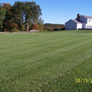

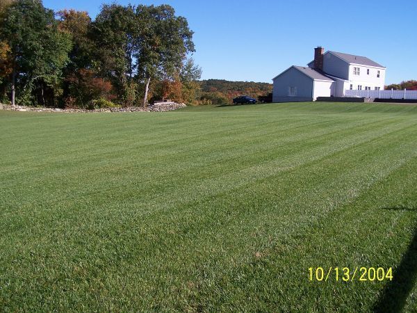

            I've heard conflicting comments about whether or not pool water would harm grass or vegetation, so I avoid doing it. The last thing I want to do is kill my golf course...er... I mean lawn LOL
            Here's one half of it...
          2. rasconc | Aug 31, 2005 07:41am | #22
            Wow, that looks great!  I could see a severely loaded filter causing a concentration that would hurt, but I would be surprised if water with a ph that you can swim in would hurt anything.  My hot tub is a different story, I thought I would be smart and use the water from my Jacuzzi to pressure wash with the aid of a sump pump.  It was very chem laden.
            caveman | Aug 31, 2005 08:00am | #23
            Hmm...maybe your right. But when I drain the filter for winter closing, it leaves a brownish path where the water flows in the grass. Probably only 20-30 gallons or so. At least it does recover the following spring.
