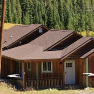

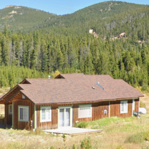

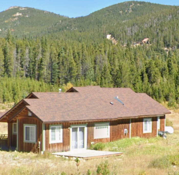

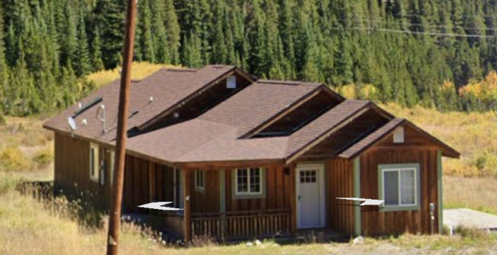

    When I built a few SIP houses with a friend in Colorado, he introduced me to 'reverse' board & batten. We ripped 3" wide strips of 1/4" plywood and nailed these under and between the boards with some filter fabric at the bottom to prevent insects from infiltrating. His reasoning was that battens always dry and crack more than the boards. We used a 1" spacing between boards and nailed on either side about 12"o.c. Personally, I like the look better than regular B&B, and it's held up well for 20 years. It looks sorta like T-111. (Pardon the pics, they're off maps).
