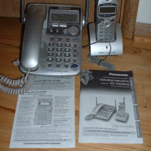

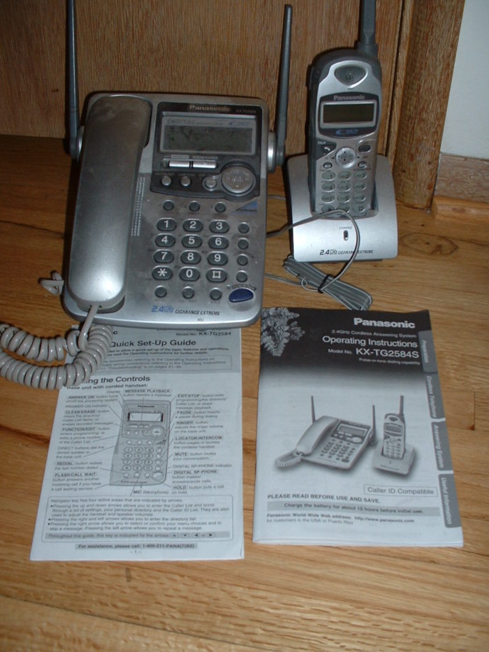

    Paul, Our house has gone completely celular so our corless phone is sitting there collecting dust.
    It is a Panasonic KX-TG2584 if you are interested.
    The reason I bought this one was because it has longer range. It has two anteanas on the base unit.
    You can have it for a song if you like.
    It's a good system. We had no problems with it at all.
