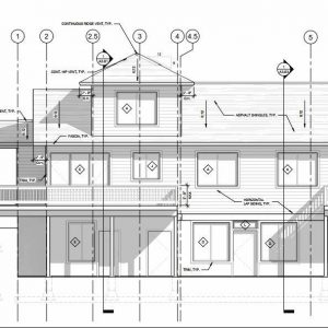

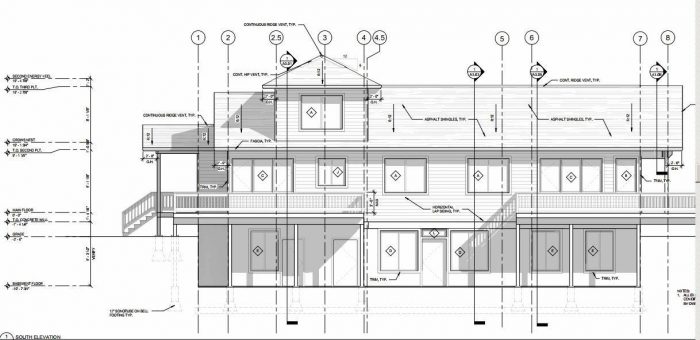

    Hello. The wall above is a wood lap siding of some sort, or a fiber cement product. Still deciding what is less cost for product value. (bang for buck) I am in a northern 4 season climate. The roof above has a 2 foot over hang. Enclosed is south side of home.Thanks for reply
